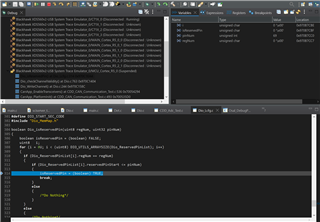

We encountered an issue with the Dio Mcal config which is generated in Tresos for our custom hardware and needs. The issue is, that the even though the port for WKUP_GPIO0_69 is configured correctly as 2 (Bank4/5, Tresos wouldn't let any other value to be configured anyway), when using this pin to wake up the CAN transceiver (just like in the J784S4 Evaluation kit), we receive a DET error with the following IDs (--> Dio invalid channel):
From the call stack we can see that this happens when Dio_isReservedPin() is called and returns TRUE, which means the pin is reserved and can't therefore be used.
However, this Dio_ReservedPinList structure is generated by Tresos and is part of Dio_Lcfg.c. The condition that leads to the return value being TRUE is Dio_ReservedPinList[i].reservedPinStart <= pinNum where pinNum is our pin which we want to write --> 69 and reservedPinStart being 32. Obviously this condition is true so no wonder that this is the behavior we see.
The condition before (Dio_ReservedPinList[i].regNum == regNum) is true because regNum is 0.
