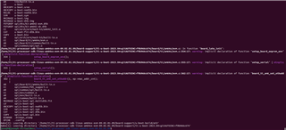

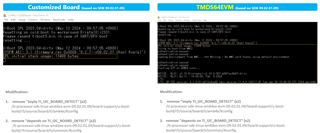

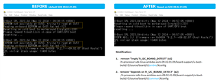

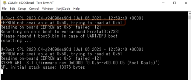

After power on, The boot process was stopped as the following figure.
I am able to compile source code. But is it possible to bypass the EEPROM checking procedure by modifying some specific configuration of the source code?
