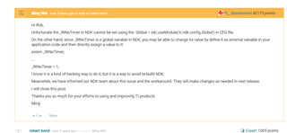

Recently we believe we may have observed an anomaly in our system related to a previous forum post linked here: https://e2e.ti.com/support/processors-group/processors/f/processors-forum/840450/ccs-am3359-tcp-ip-drops-connection. After a period of time the network interface seems to stop communicating, and the interface no longer responds to pings.
Similar to the poster, setting _RTNoTimer = 1 of stack file C:\ti\processor_sdk_rtos_am57xx_06_03_02_08\ndk_3_61_01_01\packages\ti\ndk\stack\route\rtable.c seemed to be a "workaround" for us. However, we are concerned with possible side effects of disabling the ARP table refresh requests.
Near the end of the post:
This section suggests the fixes to this particular problem will be included in the "next release".
I looked through various NDK stack version change logs and haven't been able to find a mention of this bug being fixed.
Can you verify that this problem is indeed resolved in the latest version (v3.61.1.01) of the NDK stack?

  • Hello Chris,
    Unfortunately this does not seem like it was ever fixed, I found the related internal JIRA and the fix was put off to NDK version NDK_3_85_00 Which will never be available for AM57. For now and the foreseeable future the AM57 RTOS SDK is on maintenance mode. See software-dl.ti.com/.../Release_Specific_Release_Notes.html
    This was not considered to be fixed since the issue was not very reproducible internally on our EVMs and the original reporters had mostly seen this on the Beaglebone Black EVM.
    In conclusion, I believe the workaround you have implemented is the only option available.
    Josue
