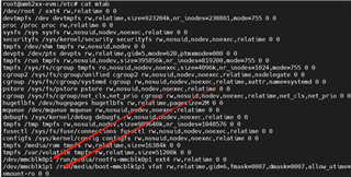

I did not implement mounting mmcblk0p1 in/run/media, similar to the one in ti-evm, in my own rootfs. I did not find any mounting when checking the fstab, but when checking the mounting situation in the mtab of ti-evm, it is shown in the figure. Can you tell me how to make the specific implementation of mounting in ti-evm work
thanks.
    This is done with the udev rules
    /tmp/fs
    ❯ rg -i mmcblk etc/udev lib/udev 2> /dev/null
    lib/udev/rules.d/60-persistent-storage.rules
    10:KERNEL!="loop*|mmcblk*[0-9]|msblk*[0-9]|mspblk*[0-9]|nvme*|sd*|sr*|vd*|xvd*|bcache*|cciss*|dasd*|ubd*|ubi*|scm*|pmem*|nbd*|zd*", GOTO="persistent_storage_end"
    79:KERNEL=="mmcblk[0-9]", SUBSYSTEMS=="mmc", ATTRS{serial}=="?*", ENV{ID_SERIAL}="$attr{serial}"
    80:KERNEL=="mmcblk[0-9]", SUBSYSTEMS=="mmc", ATTRS{name}=="?*", ENV{ID_NAME}="$attr{name}"
    81:KERNEL=="mmcblk[0-9]", ENV{ID_NAME}=="?*", ENV{ID_SERIAL}=="?*", SYMLINK+="disk/by-id/mmc-$env{ID_NAME}_$env{ID_SERIAL}"
    82:KERNEL=="mmcblk[0-9]p[0-9]*", ENV{ID_NAME}=="?*", ENV{ID_SERIAL}=="?*", SYMLINK+="disk/by-id/mmc-$env{ID_NAME}_$env{ID_SERIAL}-part%n"
    91:KERNEL=="mmcblk[0-9]boot[0-9]", ENV{DEVTYPE}=="disk", ENV{ID_PATH}=="?*", SYMLINK+="disk/by-path/$env{ID_PATH}-boot%n"
    92:KERNEL!="mmcblk[0-9]boot[0-9]", ENV{DEVTYPE}=="disk", ENV{ID_PATH}=="?*", SYMLINK+="disk/by-path/$env{ID_PATH}"
    95:KERNEL!="mmcblk[0-9]boot[0-9]", ENV{DEVTYPE}=="disk", ENV{ID_PATH_ATA_COMPAT}=="?*", SYMLINK+="disk/by-path/$env{ID_PATH_ATA_COMPAT}"
    110:KERNEL!="sr*|mmcblk[0-9]boot[0-9]", IMPORT{builtin}="blkid"
    lib/udev/rules.d/60-block.rules
    12:  KERNEL=="loop*|mmcblk*[0-9]|msblk*[0-9]|mspblk*[0-9]|nvme*|sd*|vd*|xvd*|bcache*|cciss*|dasd*|ubd*|ubi*|scm*|pmem*|nbd*|zd*", \
    etc/udev/rules.d/local.rules
    23:ACTION=="add", KERNEL=="mmcblk[0-9]p[0-9]", SUBSYSTEM=="block", RUN+="/etc/udev/scripts/mount.sh"
    24:ACTION=="remove", KERNEL=="mmcblk[0-9]p[0-9]", SUBSYSTEM=="block", RUN+="/etc/udev/scripts/mount.sh"
