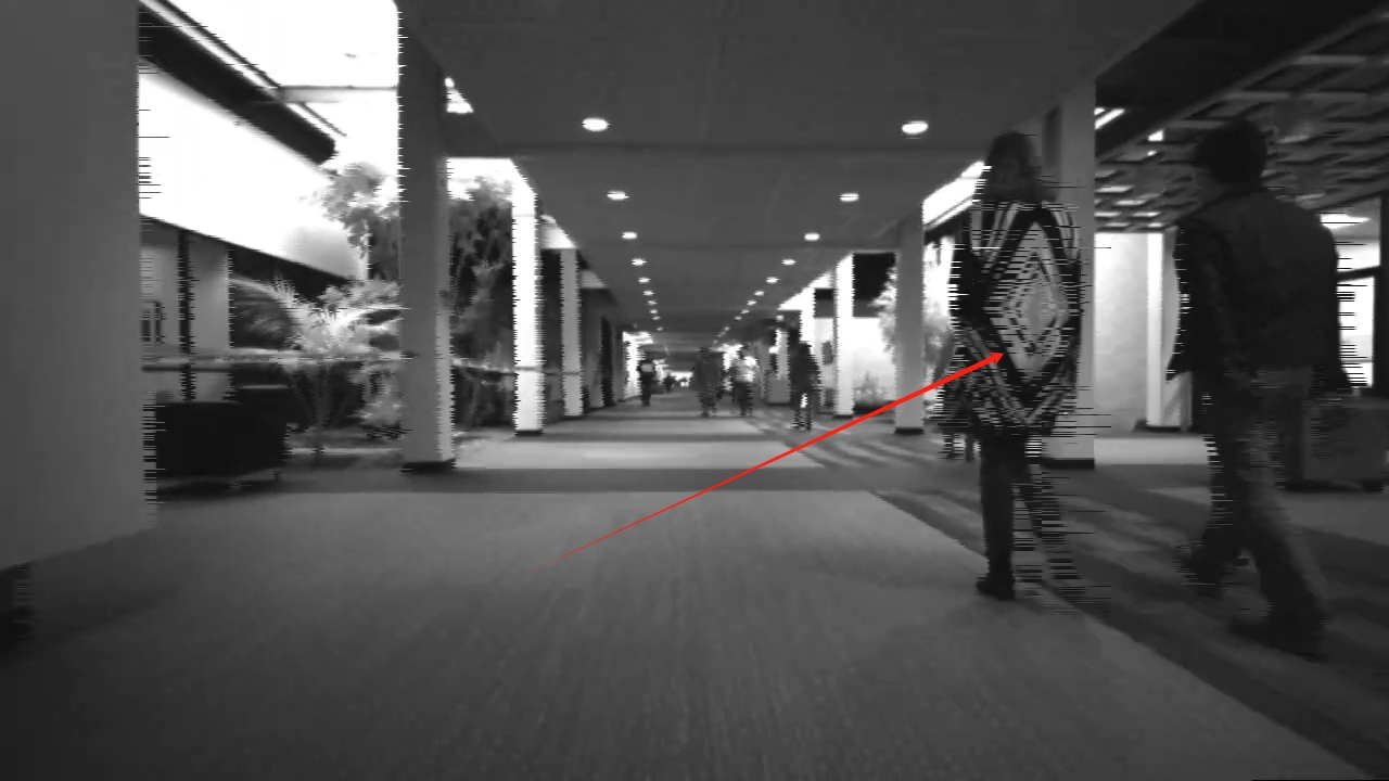

I have written a program that encodes an offline nv12 file into h264, but some edges of the encoded h264 file image have horizontal stripes。
I have checked the nv12 file and there is no such issue.please help me check what the problem may be.
h264 file:left.zip
source code: image_encode.zip

  • If I replace v4l2 buf memory with V4L2_MEMORY_MMAP in the code, it will work properly.
    req.type = V4L2_BUF_TYPE_VIDEO_OUTPUT_MPLANE;
    req.memory = V4L2_MEMORY_MMAP;
    The previously problematic code, v4l2 memory, is V4L2_MEMORY_DMABUF. I will copy the nv12 buffer to the vx_image structure, and then pass the fd obtained through appMemGetDmaBufFd to v4l2(getImageDmaFdIMG()). I still don't understand why there are problems with using this method.
    req.memory = V4L2_MEMORY_DMABUF;
    I still want to perform v4l2 encoding operations without copying memory.
