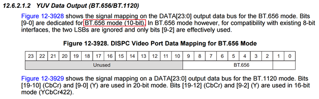

    1. Is the videoIfWidth for BT656 10bit? I refer to the following documentation:
    2.When reducing the resolution to 720P, what are the hFrontPorch, hBackPorch, hSyncLen, vFrontPorch, vBackPorch, vSyncLen sizes set?
    3. I didn't find the description of the maximum clock frequency in BT656 mode in the documentation.
    Xin
  • Hi Xin,
    Yes, in BT656 output mode, DSS outputs in 10bit interface, but you can use upper 8bits.
    Typically these parameters are different between 1080p and 720p resolution, so please change it accordingly.
    If i recollect, it was around 150MHz, but please refer to TRM for exact max frequency support.

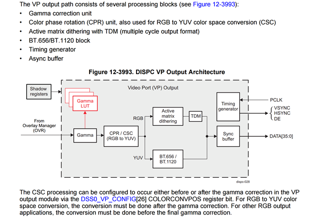

  • Hi Brijesh,
    Set BT656 output mode, in addition to modify dvoFormat, videoIfWidth, timing properties, the SDK in other places also need to set?
    Xin
  • Hi Xin,
    Pinmux is another thing that you need to take care. Please set the correct mode for the pins that you are using from DSS output.
    Since it is BT656 output mode, you would most likely require 8 or 10 datalines output.
    Brijesh

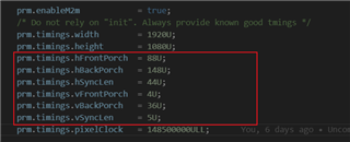

  • Hi Brijesh,
    I configured BT656 1080P 30FPS output using timings parameter below.
    static inline void appDctrlVpParamsInit(app_dctrl_vp_params_t *vpParams)
        if(NULL != vpParams)
            vpParams->vpId = APP_DSS_VP_ID_1;
            vpParams->standard     = APP_DCTRL_VID_STD_1080P_30;
            vpParams->width        = 1920U;
            vpParams->height       = 1080U;
            vpParams->hFrontPorch  = 88U;
            vpParams->hBackPorch   = 148U;
            vpParams->hSyncLen     = 44U;
            vpParams->vFrontPorch  = 4U;
            vpParams->vBackPorch   = 36U;
            vpParams->vSyncLen     = 5U;
            vpParams->pixelClock   = 148500U;
            vpParams->dvoFormat    = APP_DCTRL_DV_BT656_EMBSYNC;
            vpParams->cscRange     = APP_DSS_CSC_RANGE_FULL;
            vpParams->videoIfWidth = APP_DCTRL_VIFW_12BIT;
            vpParams->actVidPolarity   = APP_DCTRL_POL_HIGH;
            vpParams->pixelClkPolarity = APP_DCTRL_EDGE_POL_RISING;
            vpParams->hsPolarity = APP_DCTRL_POL_HIGH;
            vpParams->vsPolarity = APP_DCTRL_POL_HIGH;
            prm.timings.width        = 1920U;
            prm.timings.height       = 1080U;
            prm.timings.hFrontPorch  = 88U;
            prm.timings.hBackPorch   = 148U;
            prm.timings.hSyncLen     = 44U;
            prm.timings.vFrontPorch  = 4U;
            prm.timings.vBackPorch   = 36U;
            prm.timings.vSyncLen     = 5U;
            prm.timings.pixelClock   = 148500000ULL;

    I used an oscilloscope to measure the 8 data lines corresponding to the output of BT656, and all of them had data. The clock line frequency size of BT656 output is measured, which is corresponding to the Pixel clock size set. But the encoding chip can not output data after receiving these data.Is it possible to use the current configuration of the application layer to output BT656 format, the output data and clock do not correspond to?
    I wonder if the current configuration about display in /vision_apps/utils/dss/src/app_dss_defaults.c applies to output BT656 format? Because generally one output RGB pixel corresponds to one clock time, and two clock times correspond to one pixel when output BT656. Does our application and driver layer support setting the output BT656 format? Or is it supported at the driver level but not at the application level? Could you confirm that?
    Xin

  • Hi Xin,
    For BT656 output, you just need to set dvoFormat to BT656 output. (in the API appDctrlVpParamsInit, vpParams->dvoFormat    = APP_DCTRL_DV_BT656_EMBSYNC).
    There is no other change required, assuming pnmux is taken care.

  • Hi Brijesh,
    After modifying the timing parameter, I successfully sent 1080P BT656 format data through the DSS module.
    However, a problem was discovered:the timing parameters configured in the code were not exactly the same as those read directly from the associated timing registers. I am now directly to manually modify the register value to figure out. Here's where I changed the code:
    psdk_rtos_j7/vision_apps/platform/j721e/rtos/common/app_init.c
    Did the driver reconfigure the registers?
    Xin
  • Hi Xin,
    This is correct place for configuring timing parameter. Driver configures registers based on these provided values. What exactly difference are you using?
    Brijesh
  • Hi Brijesh,
    I looked at the code that shows the driver configuring the timing register and found that some of the parameters that the driver needs to configure are not sent by the application layer. As a result, the driver configuration is not exactly configured according to the application layer setting values, only a part of the register bits are the same.
    Xin
  • Xin,
    Can you provide more information on this? I am not sure which parameter/register driver is configuring with the incorrect value, due to it being not provided by the application.
    Brijesh
  • Hi Brijesh,
    The default driver configuration is as follows:
    if(TRUE == isCustomTiming)
                hSyncVal = blankCfg->hSyncLen & 0xFFU;
                vSyncVal = (blankCfg->hSyncLen >> 8U) & 0xFU;
                regVal = CSL_REG32_RD(&vpRegs->TIMING_H);
                if(FVID2_SF_INTERLACED == scanFormat)
                    CSL_FINS(regVal, DSS_VP1_TIMING_H_HBP, blankCfg->hBackPorch);
                    CSL_FINS(regVal, DSS_VP1_TIMING_H_HFP, blankCfg->hFrontPorch);
                CSL_FINS(regVal, DSS_VP1_TIMING_H_HSW, hSyncVal);
                CSL_REG32_WR(&vpRegs->TIMING_H, regVal);
                regVal = CSL_REG32_RD(&vpRegs->TIMING_V);
                CSL_FINS(regVal, DSS_VP1_TIMING_V_VBP, blankCfg->vBackPorch);
                CSL_FINS(regVal, DSS_VP1_TIMING_V_VFP, blankCfg->vFrontPorch);
                CSL_FINS(regVal, DSS_VP1_TIMING_V_VSW, vSyncVal);
                CSL_REG32_WR(&vpRegs->TIMING_V, regVal);
            else
                retVal = CSL_EFAIL;
    But after selecting the custom configuration timing mode and BT656 mode. The if(FVID2_SF_INTERLACED == scanFormat) condition does not apply to the module in the driver, and I don't understand why vSyncVal = (blankCfg->hSyncLen >> 8U) & 0xFU;?
    I made the following changes so that the application configuration parameters match those in the registers:
    // vSyncVal = (blankCfg->hSyncLen >> 8U) & 0xFU;
    vSyncVal = blankCfg->vSyncLen & 0xFFU;
    // if(FVID2_SF_INTERLACED == scanFormat)
    Xin
  • Hi Xin,
    The other way is to provide the parameters in a such that the driver configures it correctly. So, can you try it?
    Brijesh
