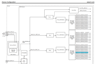

  • The WKUP_CTRL_MMR0_WKUP_GTC_CLKSEL register is stating that MAIN_PLL2_HSDIV5_CLKOUT is most likely the default option if the register bits [2-0] = 000.
  • Chasing MAIN_PLL2_HSDIV5_CLKOUT down seems to indicate that it is generated by MAIN_PLL2_REF_CLK.
  • MAIN_PLL2_REF_CLK looks like it comes from MCU_HFOSC0 which is part of the MCU domain.
  • MCU_HFOSC0 is generated by the source connected to the MCU_OSC0_XI pin.
Figure 6-92 for reference
Questions
  • So on the EVM this appears to be the 25MHz crystal (Y1)?
  • Are there any extra clock dividers happening by the time is gets to the WKUP_GTC0 interface?

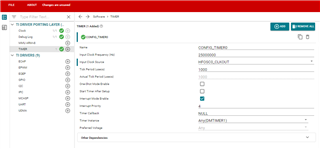

  • Hi Paul,
    I am more on the applications side of things so I am not quite sure what I am looking at. I can't find any reference to the WKUP_GTC interface or the PLL2_HSDIV5_CLKOUT in the online sysconfig tool in the Timers section.
    I was really hoping for a quick confirmation of what the default setting is on the EVK because we have our own custom hardware that we are trying to debug.
    Thank You,
    Spencer

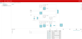

  • Hi Spencer,
    In your SYSCONFIG screenshot, it seems you are not using the AM6X Clock Tree software product. The default software product helps to configure the peripherals and the device settings, but does not show the clock tree diagram. To show the clock tree diagram, you can either use the direct link for the AM62Ax device found on the CLOCKTREETOOL page on TI.com, or select the AM6X Clock Tree from the Software Product dropdown menu.

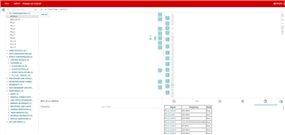

    Once the Clock Tree tool is opened, you should see the following screen:
    On the sidebar, you can search for the peripherals you would like to trace, in this case, WKUP_GTC0. The tool does not allow underscores in the search bar, so typing "WKUP_GTC0" will not provide any results. Instead, typing "GTC" and expanding the "TIMER MODULES" section will allow you to select the WKUP_GTC0 view. You will then see the following view:
    In this view, you can trace the two clock inputs to WKUP_GTC0. The fclk input is sourced by the 25 MHz oscillator, which passes through the clock loss mux, PLL0 and its HSDIV6 output, and the MAIN_GTCCLK_SEL mux. This shows the default frequency on the fclk pin of WKUP_GTC0 is 250 MHz. This corresponds with the path you and Paul have found from the TRM.
    Megan
