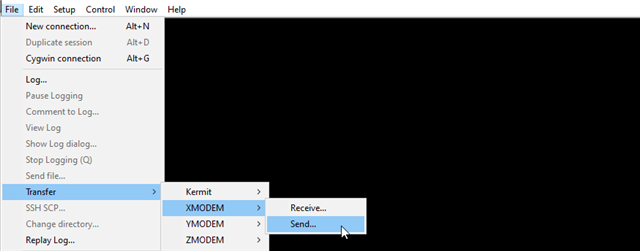

    Additionally, you can also try booting the `sbl_uart_uniflash_stage1.release.tiimage` alone using Teraterm. Simply send the image using XMODEM as shown
    If this gets sent successfully, comment the `--flash-writer` line in .cfg file and start the flashing procedure for the rest of the images.
