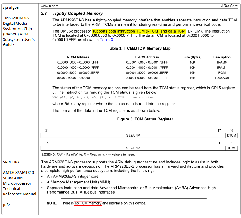

ARM specification defines TCM memory which offers performance similar to cache. With interest on this, I searched keyword TCM in documents of AM1808 and other TI's ARM-based/equipped processors:
The result seems to be:
1.    Some have TCM, for example, DM36x
2.    Some don't, including AM1808
Is it true? AM1808 just didn't implement TCM?
Zheng
    That is correct, no TCM on AM18x/OMAPL1x devices.
