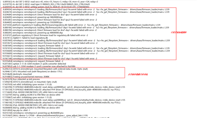

2. Problem scenarios:
In the recent period, we have encountered two problems where the DSP and M4 core failed to start during the startup process of AM5716.
When I encountered the problem for the first time, I found through the application log that the M4 core IPC could not communicate. I tried to find error information in the trace log, but found that no trace log was generated.
If it is suspected that the M4 core fails to start, check whether the M4 core firmware file size is normal.
Kill the lad_dra7xx process, manually execute unbind and bind and try to pull up the M4 core again. It was found that the M4 core can start normally.
3. Analysis process:
Part of the dmesg information when the problem occurred is as follows:
Part of the dmesg information after the faulty device is restarted is as follows:
DSP and M4 core firmware are stored in the /lib/firmware directory of the Linux file system. By comparing the two startup logs, it is suspected that when the problem occurred, the root file system had not been mounted, causing the real-time core to fail to load the firmware.
When encountering the problem for the second time, the trace log was not generated. The initial judgment was that the DSP core failed to start. The difference is that the scene tried to pull up the DSP core again, but it still couldn't. Since the device has been restarted, the dmesg information is not retained, only lad.txt generated by the lad_dra7xx process is retained.

The background of the second real-time core startup failure was that the tester upgraded the application. The steps were: (1) Upload the upgrade package via http on the web page; (2) Decompress the upgrade package; (3) Restart.
The two operations are similar, that is, replacing the application, and it is suspected that the problem is the same. The question is, compared with normal circumstances, why does it take nearly 10 seconds for the root file system to start mounting? And this problem is not easy to reproduce.
Zekun
  • Hello Zekun,
    I have a couple of questions.
    1. Is there a specific reason why they are using offset releases? They are using Linux kernel that belongs to SDK release 06_03_00_106
    and the RTOS SDK they are using is :
    processor_sdk_rtos_am57xx_08_01_00_09
    This is not the recommended RTOS release for Linux kernel 4.19.94, one cannot  mix and match SDK RTOS versions with different Linux SDK versions.
    The Linux kernel remoteproc/rpmsg framework can change from LTS kernel to LTS kernel, which requires the correct IPC version.
    In this case, the IPC seems to be the same but I need to double check to see if there aren't any other differences..
    2.
    Can you explain what you mean by normal circumstances? what are these?
    3. What is the difference between the log screen captures in your #3? One shows the mounting ~6 seconds and the other ~16 s?
    -Josue
  • There are  dmesg information when the problem occurred  and reboot belong to the same device.
  • Normal circumstances mean DSP and M4 cores boot normally. The firmware loads successfully when linux booting in most cases.
    Could you please upload a file including your entire boot log?  Working and non-working? Please use  Insert-->File-->Upload method, this helps make the thread easy to navigate.
    -Josue

    [ 7.910067] remoteproc remoteproc2: powering up 4b2b4000.pru
    [ 8.460105] usb 3-1: USB disconnect, device number 2
    [ 8.746078] remoteproc remoteproc4: loading /lib/firmware/dra7-ipu1-fw.xem4 failed with error -2 fuc<fw_get_filesystem_firmware>: drivers/base/firmware_loader/main.c L339
    [ 8.766772] remoteproc remoteproc4: Direct firmware load for dra7-ipu1-fw.xem4 failed with error -2
    [ 8.778920] remoteproc remoteproc4: powering up 58820000.ipu
    [ 8.808328] platform regulatory.0: loading /lib/firmware/regulatory.db failed with error -2 fuc<fw_get_filesystem_firmware>: drivers/base/firmware_loader/main.c L339
    [ 8.825433] platform regulatory.0: Direct firmware load for regulatory.db failed with error -2
    [ 8.836041] cfg80211: failed to load regulatory.db
    [ 8.916876] remoteproc remoteproc5: loading /lib/firmware/dra7-ipu2-fw.xem4 successfully! drivers/base/firmware_loader/main.c L349
    [ 8.930929] remoteproc remoteproc5: powering up 55020000.ipu
    [ 8.938598] remoteproc remoteproc5: Booting fw image dra7-ipu2-fw.xem4, size 5764992
    [ 8.947746] omap-iommu 55082000.mmu: 55082000.mmu: version 2.1
    [ 8.955516] remoteproc remoteproc6: loading /lib/firmware/dra7-dsp1-fw.xe66 successfully! drivers/base/firmware_loader/main.c L349
    [ 8.977258] remoteproc remoteproc6: powering up 40800000.dsp
    [ 8.989255] remoteproc remoteproc6: Booting fw image dra7-dsp1-fw.xe66, size 6918652
    [ 9.003913] omap-iommu 40d01000.mmu: 40d01000.mmu: version 3.0
    [ 9.009830] omap-iommu 40d02000.mmu: 40d02000.mmu: version 3.0
    [ 9.018086] virtio_rpmsg_bus virtio0: rpmsg host is online
    [ 9.023686] remoteproc remoteproc5: registered virtio0 (type 7)
    [ 9.032254] remoteproc remoteproc5: remote processor 55020000.ipu is now up
    [ 9.047538] virtio_rpmsg_bus virtio0: creating channel rpmsg-proto addr 0x3d
    [ 9.055952] virtio_rpmsg_bus virtio1: rpmsg host is online
    [ 9.055996] remoteproc remoteproc6: registered virtio1 (type 7)
    [ 9.056003] remoteproc remoteproc6: remote processor 40800000.dsp is now up
    [ 9.076966] virtio_rpmsg_bus virtio1: creating channel rpmsg-proto addr 0x3d
    [ 9.644920] (NULL device *): CPSW-- drivers/net/ethernet/ti/cpsw.c _cpsw_adjust_link L1195
    [ 9.653300] cpsw 48484000.ethernet eth0: drivers/net/phy/phy.c L74 Link is Up-- - 100Mbps/Full - flow control off
    [ 9.962635] remoteproc remoteproc2: loading /lib/firmware/ti-pruss/am57xx-pru0-prueth-fw.elf successfully! drivers/base/firmware_loader/main.c L349
    [ 9.976321] remoteproc remoteproc2: Booting fw image ti-pruss/am57xx-pru0-prueth-fw.elf, size 7228
    [ 9.985918] pruss 4b280000.pruss: configured system_events[63-0] = 00000600,04500000
    [ 9.993812] pruss 4b280000.pruss: configured intr_channels = 0x000000d5 host_intr = 0x00000155
    [ 10.002544] remoteproc remoteproc2: remote processor 4b2b4000.pru is now up
    [ 10.010096] net eth2: started
    [ 10.013254] IPv6: ADDRCONF(NETDEV_UP): eth2: link is not ready
    [ 10.019157] 8021q: adding VLAN 0 to HW filter on device eth2
    [ 10.025096] IPv6: ADDRCONF(NETDEV_CHANGE): eth0: link becomes ready
    [ 10.036355] remoteproc remoteproc3: powering up 4b2b8000.pru
    [ 10.178273] usb 3-1: new high-speed USB device number 3 using xhci-hcd
    [ 10.311643] usb 3-1: config 1 interface 0 altsetting 0 endpoint 0x81 has an invalid bInterval 32, changing to 9
    [ 10.322317] usb 3-1: New USB device found, idVendor=1782, idProduct=4d11, bcdDevice= 0.00
    [ 10.330700] usb 3-1: New USB device strings: Mfr=1, Product=2, SerialNumber=0
    [ 10.337953] usb 3-1: Product: L610
    [ 10.341481] usb 3-1: Manufacturer: FIBOCOM
    [ 10.792291] remoteproc remoteproc4: loading /lib/firmware/dra7-ipu1-fw.xem4 failed with error -2 fuc<fw_get_filesystem_firmware>: drivers/base/firmware_loader/main.c L339
    [ 10.807896] remoteproc remoteproc4: Direct firmware load for dra7-ipu1-fw.xem4 failed with error -2
    [ 10.817037] remoteproc remoteproc4: request_firmware failed: -2
    [ 12.074090] remoteproc remoteproc3: loading /lib/firmware/ti-pruss/am57xx-pru1-prueth-fw.elf successfully! drivers/base/firmware_loader/main.c L349
    [ 12.087848] remoteproc remoteproc3: Booting fw image ti-pruss/am57xx-pru1-prueth-fw.elf, size 7256
    [ 12.097575] pruss 4b280000.pruss: configured system_events[63-0] = 00600000,08a00000
    [ 12.105471] pruss 4b280000.pruss: configured intr_channels = 0x0000032a host_intr = 0x000002aa
    [ 12.114349] remoteproc remoteproc3: remote processor 4b2b8000.pru is now up
    [ 12.121611] net eth3: started
    [ 12.124716] IPv6: ADDRCONF(NETDEV_UP): eth3: link is not ready
    [ 12.130620] 8021q: adding VLAN 0 to HW filter on device eth3
    [ 12.136900] cdc_ether 3-1:1.0 usb0: register 'cdc_ether' at usb-xhci-hcd.1.auto-1, CDC Ethernet Device, f0:4b:b3:b9:eb:e5
    [ 12.155395] option 3-1:1.2: GSM modem (1-port) converter detected
    [ 12.167193] usb 3-1: GSM modem (1-port) converter now attached to ttyUSB0
    [ 12.176558] option 3-1:1.3: GSM modem (1-port) converter detected
    [ 12.185956] usb 3-1: GSM modem (1-port) converter now attached to ttyUSB1

    root@SunGrow:/sys/bus/platform/drivers/omap-rproc# dmesg
    [ 0.000000] Booting Linux on physical CPU 0x0
    [ 0.000000] Linux version 4.19.94-rt39SunGrow-ga242ccf3f1 (root@vir) (gcc version 8.3.0 (GNU Toolchain for the A-profile Architecture 8.3-2019.03 (arm-rel-8.36))) #1 SMP PREEMPT Wed Sep 7 16:57:46 CST 2022
    [ 0.000000] CPU: ARMv7 Processor [412fc0f2] revision 2 (ARMv7), cr=30c5387d
    [ 0.000000] CPU: div instructions available: patching division code
    [ 0.000000] CPU: PIPT / VIPT nonaliasing data cache, PIPT instruction cache
    [ 0.000000] OF: fdt: Machine model: TI AM5718 IDK
    [ 0.000000] Memory policy: Data cache writealloc
    [ 0.000000] efi: Getting EFI parameters from FDT:
    [ 0.000000] efi: UEFI not found.
    [ 0.000000] Reserved memory: created CMA memory pool at 0x0000000095800000, size 56 MiB
    [ 0.000000] OF: reserved mem: initialized node ipu2-memory@95800000, compatible id shared-dma-pool
    [ 0.000000] Reserved memory: created CMA memory pool at 0x0000000099000000, size 64 MiB
    [ 0.000000] OF: reserved mem: initialized node dsp1-memory@99000000, compatible id shared-dma-pool
    [ 0.000000] Reserved memory: created CMA memory pool at 0x000000009d000000, size 32 MiB
    [ 0.000000] OF: reserved mem: initialized node ipu1-memory@9d000000, compatible id shared-dma-pool
    [ 0.000000] cma: Reserved 24 MiB at 0x00000000be400000
    [ 0.000000] OMAP4: Map 0x00000000bfd00000 to (ptrval) for dram barrier
    [ 0.000000] Hit pending asynchronous external abort (FSR=0x00001211) during first unmask, this is most likely caused by a firmware/bootloader bug.
    [ 0.000000] On node 0 totalpages: 211968
    [ 0.000000] DMA zone: 1728 pages used for memmap
    [ 0.000000] DMA zone: 0 pages reserved
    [ 0.000000] DMA zone: 147200 pages, LIFO batch:31
    [ 0.000000] HighMem zone: 64768 pages, LIFO batch:15
    [ 0.000000] DRA722 ES2.0
    [ 0.000000] random: get_random_bytes called from start_kernel+0xb0/0x474 with crng_init=0
    [ 0.000000] percpu: Embedded 15 pages/cpu s32524 r8192 d20724 u61440
    [ 0.000000] pcpu-alloc: s32524 r8192 d20724 u61440 alloc=15*4096
    [ 0.000000] pcpu-alloc: [0] 0
    [ 0.000000] Built 1 zonelists, mobility grouping on. Total pages: 210240
    [ 0.000000] Kernel command line: console=ttyS2,115200n8 root=PARTUUID=ce8126ed-02 rw rootfstype=ext4 rootwait
    [ 0.000000] Dentry cache hash table entries: 131072 (order: 8, 1048576 bytes)
    [ 0.000000] Inode-cache hash table entries: 65536 (order: 6, 262144 bytes)
    [ 0.000000] Memory: 634644K/847872K available (14336K kernel code, 618K rwdata, 4152K rodata, 2048K init, 305K bss, 33004K reserved, 180224K cma-reserved, 234496K highmem)
    [ 0.000000] Virtual kernel memory layout:
    vector : 0xffff0000 - 0xffff1000 ( 4 kB)
    fixmap : 0xffc00000 - 0xfff00000 (3072 kB)
    vmalloc : 0xf0800000 - 0xff800000 ( 240 MB)
    lowmem : 0xc0000000 - 0xf0000000 ( 768 MB)
    pkmap : 0xbfe00000 - 0xc0000000 ( 2 MB)
    modules : 0xbf000000 - 0xbfe00000 ( 14 MB)
    .text : 0x(ptrval) - 0x(ptrval) (16352 kB)
    .init : 0x(ptrval) - 0x(ptrval) (2048 kB)
    .data : 0x(ptrval) - 0x(ptrval) ( 619 kB)
    .bss : 0x(ptrval) - 0x(ptrval) ( 306 kB)
    [ 0.000000] SLUB: HWalign=64, Order=0-3, MinObjects=0, CPUs=1, Nodes=1
    [ 0.000000] rcu: Preemptible hierarchical RCU implementation.
    [ 0.000000] rcu: RCU restricting CPUs from NR_CPUS=2 to nr_cpu_ids=1.
    [ 0.000000] Tasks RCU enabled.
    [ 0.000000] rcu: Adjusting geometry for rcu_fanout_leaf=16, nr_cpu_ids=1
    [ 0.000000] NR_IRQS: 16, nr_irqs: 16, preallocated irqs: 16
    [ 0.000000] GIC: Using split EOI/Deactivate mode
    [ 0.000000] OMAP clockevent source: timer1 at 32786 Hz
    [ 0.000000] arch_timer: cp15 timer(s) running at 6.14MHz (phys).
    [ 0.000000] clocksource: arch_sys_counter: mask: 0xffffffffffffff max_cycles: 0x16af5adb9, max_idle_ns: 440795202250 ns
    [ 0.000005] sched_clock: 56 bits at 6MHz, resolution 162ns, wraps every 4398046511023ns
    [ 0.000019] Switching to timer-based delay loop, resolution 162ns
    [ 0.000299] clocksource: 32k_counter: mask: 0xffffffff max_cycles: 0xffffffff, max_idle_ns: 58327039986419 ns
    [ 0.000310] OMAP clocksource: 32k_counter at 32768 Hz
    [ 0.000734] Console: colour dummy device 80x30
    [ 0.000806] Calibrating delay loop (skipped), value calculated using timer frequency.. 12.29 BogoMIPS (lpj=6147)
    [ 0.000823] pid_max: default: 32768 minimum: 301
    [ 0.000962] Mount-cache hash table entries: 2048 (order: 1, 8192 bytes)
    [ 0.000981] Mountpoint-cache hash table entries: 2048 (order: 1, 8192 bytes)
    [ 0.001601] CPU: Testing write buffer coherency: ok
    [ 0.001644] CPU0: Spectre v2: using ICIALLU workaround
    [ 0.001910] /cpus/cpu@0 missing clock-frequency property
    [ 0.001930] CPU0: thread -1, cpu 0, socket 0, mpidr 80000000
    [ 0.007974] Setting up static identity map for 0x80200000 - 0x80200060
    [ 0.009980] rcu: Hierarchical SRCU implementation.
    [ 0.019851] EFI services will not be available.
    [ 0.021196] smp: Bringing up secondary CPUs ...
    [ 0.021212] smp: Brought up 1 node, 1 CPU
    [ 0.021226] SMP: Total of 1 processors activated (12.29 BogoMIPS).
    [ 0.021237] CPU: All CPU(s) started in HYP mode.
    [ 0.021248] CPU: Virtualization extensions available.
    [ 0.021749] devtmpfs: initialized
    [ 0.042643] VFP support v0.3: implementor 41 architecture 4 part 30 variant f rev 0
    [ 0.042955] clocksource: jiffies: mask: 0xffffffff max_cycles: 0xffffffff, max_idle_ns: 1911260446275000 ns
    [ 0.042979] futex hash table entries: 256 (order: 2, 16384 bytes)
    [ 0.046114] xor: measuring software checksum speed
    [ 0.055729] arm4regs : 2020.000 MB/sec
    [ 0.065801] 8regs : 1632.000 MB/sec
    [ 0.075890] 32regs : 1520.000 MB/sec
    [ 0.075904] xor: using function: arm4regs (2020.000 MB/sec)
    [ 0.075923] pinctrl core: initialized pinctrl subsystem
    [ 0.076547] DMI not present or invalid.
    [ 0.076862] NET: Registered protocol family 16
    [ 0.078438] DMA: preallocated 256 KiB pool for atomic coherent allocations
    [ 0.079729] omap_hwmod: l3_main_2 using broken dt data from ocp
    [ 0.127366] (NULL device *): ti,no-reset-on-init (gpio5) (arch/arm/mach-omap2/omap_hwmod.c _init L2423)
    [ 0.165901] (NULL device *): ti,no-reset-on-init (mmu_ipu1) (arch/arm/mach-omap2/omap_hwmod.c _init L2423)
    [ 0.185333] (NULL device *): ti,no-reset-on-init (timer7) (arch/arm/mach-omap2/omap_hwmod.c _init L2423)
    [ 0.186321] (NULL device *): ti,no-reset-on-init (timer8) (arch/arm/mach-omap2/omap_hwmod.c _init L2423)
    [ 0.189194] (NULL device *): ti,no-reset-on-init (timer11) (arch/arm/mach-omap2/omap_hwmod.c _init L2423)
    [ 0.191162] (NULL device *): ti,no-reset-on-init (timer14) (arch/arm/mach-omap2/omap_hwmod.c _init L2423)
    [ 0.259446] omap_hwmod: gpu: _wait_target_ready failed: -16
    [ 0.259463] omap_hwmod: gpu: cannot be enabled for reset (3)
    [ 0.330952] cpuidle: using governor menu
    [ 0.333126] ------------[ cut here ]------------
    [ 0.333154] WARNING: CPU: 0 PID: 23 at drivers/bus/omap_l3_noc.c:147 l3_interrupt_handler+0x330/0x380
    [ 0.333166] 44000000.ocp:L3 Custom Error: MASTER MPU TARGET L4_CFG (Read): Data Access in User mode during Functional access
    [ 0.333175] Modules linked in:
    [ 0.333191] CPU: 0 PID: 23 Comm: irq/23-l3-app-i Not tainted 4.19.94-rt39SunGrow-ga242ccf3f1 #1
    [ 0.333201] Hardware name: Generic DRA72X (Flattened Device Tree)
    [ 0.333210] Backtrace:
    [ 0.333229] [<c020d93c>] (dump_backtrace) from [<c020db94>] (show_stack+0x18/0x1c)
    [ 0.333243] r7:60000013 r6:c1874610 r5:00000000 r4:c1874610
    [ 0.333259] [<c020db7c>] (show_stack) from [<c0e405b0>] (dump_stack+0x8c/0xa0)
    [ 0.333273] [<c0e40524>] (dump_stack) from [<c02341e4>] (__warn+0xdc/0xf8)
    [ 0.333285] r7:c12ffdc4 r6:00000009 r5:00000000 r4:ef1fbe24
    [ 0.333298] [<c0234108>] (__warn) from [<c0233e34>] (warn_slowpath_fmt+0x50/0x6c)
    [ 0.333310] r9:ef1da840 r8:f0880564 r7:c12ffcf0 r6:c12ffc30 r5:c12ffd94 r4:c18064c8
    [ 0.333324] [<c0233de8>] (warn_slowpath_fmt) from [<c070a8e4>] (l3_interrupt_handler+0x330/0x380)
    [ 0.333335] r3:ef1e0100 r2:c12ffd94
    [ 0.333344] r5:00000002 r4:80080003
    [ 0.333362] [<c070a5b4>] (l3_interrupt_handler) from [<c0293914>] (irq_forced_thread_fn+0x2c/0xb0)
    [ 0.333374] r10:00000001 r9:ef1e0600 r8:c02938e8 r7:00000000 r6:ffffe000 r5:ef1e0600
    [ 0.333383] r4:ef1d9e00
    [ 0.333397] [<c02938e8>] (irq_forced_thread_fn) from [<c0293cf8>] (irq_thread+0x140/0x210)
    [ 0.333408] r7:00000000 r6:ffffe000 r5:ef1d9e00 r4:ef1e0624
    [ 0.333424] [<c0293bb8>] (irq_thread) from [<c0252f84>] (kthread+0x160/0x168)
    [ 0.333436] r10:ef093a7c r9:c0293bb8 r8:ef1e0600 r7:ef1fa000 r6:00000000 r5:ef1e0640
    [ 0.333444] r4:ef1e0680
    [ 0.333458] [<c0252e24>] (kthread) from [<c02010e0>] (ret_from_fork+0x14/0x34)
    [ 0.333467] Exception stack(0xef1fbfb0 to 0xef1fbff8)
    [ 0.333478] bfa0: 00000000 00000000 00000000 00000000
    [ 0.333490] bfc0: 00000000 00000000 00000000 00000000 00000000 00000000 00000000 00000000
    [ 0.333500] bfe0: 00000000 00000000 00000000 00000000 00000013 00000000
    [ 0.333513] r10:00000000 r9:00000000 r8:00000000 r7:00000000 r6:00000000 r5:c0252e24
    [ 0.333521] r4:ef1e0640
    [ 0.333534] ---[ end trace b4bd6a0741ab8f77 ]---
    [ 0.345003] gpio gpiochip0: (gpio-0-31): added GPIO chardev (254:0)
    [ 0.345088] gpiochip_setup_dev: registered GPIOs 0 to 31 on device: gpiochip0 (gpio-0-31)
    [ 0.345336] OMAP GPIO hardware version 0.1
    [ 0.346101] gpio gpiochip1: (gpio-32-63): added GPIO chardev (254:1)
    [ 0.346223] gpiochip_setup_dev: registered GPIOs 32 to 63 on device: gpiochip1 (gpio-32-63)
    [ 0.347136] gpio gpiochip2: (gpio-64-95): added GPIO chardev (254:2)
    [ 0.347240] gpiochip_setup_dev: registered GPIOs 64 to 95 on device: gpiochip2 (gpio-64-95)
    [ 0.348138] gpio gpiochip3: (gpio-96-127): added GPIO chardev (254:3)
    [ 0.348249] gpiochip_setup_dev: registered GPIOs 96 to 127 on device: gpiochip3 (gpio-96-127)
    [ 0.349125] gpio gpiochip4: (gpio-128-159): added GPIO chardev (254:4)
    [ 0.349242] gpiochip_setup_dev: registered GPIOs 128 to 159 on device: gpiochip4 (gpio-128-159)
    [ 0.350152] gpio gpiochip5: (gpio-160-191): added GPIO chardev (254:5)
    [ 0.350254] gpiochip_setup_dev: registered GPIOs 160 to 191 on device: gpiochip5 (gpio-160-191)
    [ 0.351152] gpio gpiochip6: (gpio-192-223): added GPIO chardev (254:6)
    [ 0.351255] gpiochip_setup_dev: registered GPIOs 192 to 223 on device: gpiochip6 (gpio-192-223)
    [ 0.352164] gpio gpiochip7: (gpio-224-255): added GPIO chardev (254:7)
    [ 0.352268] gpiochip_setup_dev: registered GPIOs 224 to 255 on device: gpiochip7 (gpio-224-255)
    [ 0.379191] hw-breakpoint: found 5 (+1 reserved) breakpoint and 4 watchpoint registers.
    [ 0.379208] hw-breakpoint: maximum watchpoint size is 8 bytes.
    [ 0.380534] OMAP DMA hardware revision 0.0
    [ 0.415738] raid6: int32x1 gen() 226 MB/s
    [ 0.432655] raid6: int32x1 xor() 255 MB/s
    [ 0.449786] raid6: int32x2 gen() 343 MB/s
    [ 0.467014] raid6: int32x2 xor() 326 MB/s
    [ 0.484193] raid6: int32x4 gen() 371 MB/s
    [ 0.501267] raid6: int32x4 xor() 351 MB/s
    [ 0.518443] raid6: int32x8 gen() 433 MB/s
    [ 0.535634] raid6: int32x8 xor() 328 MB/s
    [ 0.535647] raid6: using algorithm int32x8 gen() 433 MB/s
    [ 0.535658] raid6: .... xor() 328 MB/s, rmw enabled
    [ 0.535669] raid6: using intx1 recovery algorithm
    [ 0.538341] edma 43300000.edma: memcpy is disabled
    [ 0.542494] edma 43300000.edma: TI EDMA DMA engine driver
    [ 0.551615] omap-dma-engine 4a056000.dma-controller: OMAP DMA engine driver (LinkedList1/2/3 supported)
    [ 0.552420] of_get_named_gpiod_flags: can't parse 'gpio' property of node '/fixedregulator-vmain[0]'
    [ 0.552721] of_get_named_gpiod_flags: can't parse 'gpio' property of node '/fixedregulator-v3_3d[0]'
    [ 0.553078] of_get_named_gpiod_flags: can't parse 'gpio' property of node '/fixedregulator-vtt[0]'
    [ 0.556604] omap-iommu 40d01000.mmu: 40d01000.mmu registered
    [ 0.557011] omap-iommu 40d02000.mmu: 40d02000.mmu registered
    [ 0.557476] omap-iommu 58882000.mmu: 58882000.mmu registered
    [ 0.557936] omap-iommu 55082000.mmu: 55082000.mmu registered
    [ 0.558424] iommu: Adding device 58820000.ipu to group 1
    [ 0.558547] iommu: Adding device 55020000.ipu to group 2
    [ 0.558749] iommu: Adding device 40800000.dsp to group 0
    [ 0.560069] SCSI subsystem initialized
    [ 0.560737] libata version 3.00 loaded.
    [ 0.560950] usbcore: registered new interface driver usbfs
    [ 0.561017] usbcore: registered new interface driver hub
    [ 0.561072] usbcore: registered new device driver usb
    [ 0.562680] palmas 0-0058: Irq flag is 0x00000004
    [ 0.576935] palmas 0-0058: Muxing GPIO 2b, PWM 0, LED 0
    [ 0.579003] SMPS12: supplied by regulator-dummy
    [ 0.580991] SMPS3: supplied by VMAIN
    [ 0.582793] SMPS45: supplied by regulator-dummy
    [ 0.584889] SMPS6: supplied by VMAIN
    [ 0.586837] SMPS7: supplied by VMAIN
    [ 0.588947] SMPS8: supplied by VMAIN
    [ 0.590383] SMPS9: supplied by VMAIN
    [ 0.591511] LDO1: supplied by VMAIN
    [ 0.593729] random: fast init done
    [ 0.593989] LDO2: supplied by VMAIN
    [ 0.595841] LDO3: supplied by VMAIN
    [ 0.597871] LDO4: supplied by VMAIN
    [ 0.599916] LDO5: supplied by regulator-dummy
    [ 0.600729] LDO6: supplied by regulator-dummy
    [ 0.601529] LDO7: supplied by regulator-dummy
    [ 0.602371] LDO8: supplied by regulator-dummy
    [ 0.603167] LDO9: supplied by VMAIN
    [ 0.605341] LDOLN: supplied by VMAIN
    [ 0.606998] LDOUSB: supplied by VMAIN
    [ 0.611777] omap_i2c 48070000.i2c: bus 0 rev0.12 at 400 kHz
    [ 0.612579] omap_i2c 48072000.i2c: bus 1 rev0.12 at 400 kHz
    [ 0.613245] omap_i2c 48060000.i2c: bus 2 rev0.12 at 100 kHz
    [ 0.613919] (NULL device *): reset-gpios fuc<devm_gpiod_get_index_optional>: drivers/gpio/devres.c L247
    [ 0.613935] (NULL device *): reset-gpios fuc<devm_gpiod_get_index>: drivers/gpio/devres.c L115
    [ 0.613952] pca953x 3-0024: GPIO lookup for consumer reset
    [ 0.613961] pca953x 3-0024: using device tree for GPIO lookup
    [ 0.613981] of_get_named_gpiod_flags: can't parse 'reset-gpios' property of node '/ocp/i2c@4807a000/tca9535@24[0]'
    [ 0.613998] of_get_named_gpiod_flags: can't parse 'reset-gpio' property of node '/ocp/i2c@4807a000/tca9535@24[0]'
    [ 0.614010] pca953x 3-0024: using lookup tables for GPIO lookup
    [ 0.614019] pca953x 3-0024: No GPIO consumer reset found
    [ 0.614064] pca953x 3-0024: 3-0024 supply vcc not found, using dummy regulator
    [ 0.614154] pca953x 3-0024: Linked as a consumer to regulator.0
    [ 0.626119] gpiochip_find_base: found new base at 496
    [ 0.626296] gpio gpiochip8: (pca9535): added GPIO chardev (254:8)
    [ 0.626390] gpiochip_setup_dev: registered GPIOs 496 to 511 on device: gpiochip8 (pca9535)
    [ 0.626451] omap_i2c 4807a000.i2c: bus 3 rev0.12 at 400 kHz
    [ 0.626800] pps_core: LinuxPPS API ver. 1 registered
    [ 0.626814] pps_core: Software ver. 5.3.6 - Copyright 2005-2007 Rodolfo Giometti <giometti@linux.it>
    [ 0.626840] PTP clock support registered
    [ 0.626876] EDAC MC: Ver: 3.0.0
    [ 0.628379] omap-mailbox 48840000.mailbox: omap mailbox rev 0x400
    [ 0.628642] omap-mailbox 48842000.mailbox: omap mailbox rev 0x400
    [ 0.630287] Bluetooth: Core ver 2.22
    [ 0.630334] NET: Registered protocol family 31
    [ 0.630347] Bluetooth: HCI device and connection manager initialized
    [ 0.630366] Bluetooth: HCI socket layer initialized
    [ 0.630383] Bluetooth: L2CAP socket layer initialized
    [ 0.630431] Bluetooth: SCO socket layer initialized
    [ 0.630971] clocksource: Switched to clocksource arch_sys_counter
    [ 0.641472] NET: Registered protocol family 2
    [ 0.642203] tcp_listen_portaddr_hash hash table entries: 512 (order: 0, 6144 bytes)
    [ 0.642238] TCP established hash table entries: 8192 (order: 3, 32768 bytes)
    [ 0.642306] TCP bind hash table entries: 8192 (order: 4, 65536 bytes)
    [ 0.642435] TCP: Hash tables configured (established 8192 bind 8192)
    [ 0.642522] UDP hash table entries: 512 (order: 2, 16384 bytes)
    [ 0.642562] UDP-Lite hash table entries: 512 (order: 2, 16384 bytes)
    [ 0.642712] NET: Registered protocol family 1
    [ 0.646370] RPC: Registered named UNIX socket transport module.
    [ 0.646384] RPC: Registered udp transport module.
    [ 0.646394] RPC: Registered tcp transport module.
    [ 0.646403] RPC: Registered tcp NFSv4.1 backchannel transport module.
    [ 0.647872] PCI: CLS 0 bytes, default 64
    [ 0.649451] hw perfevents: enabled with armv7_cortex_a15 PMU driver, 7 counters available
    [ 0.651498] Initialise system trusted keyrings
    [ 0.651757] workingset: timestamp_bits=14 max_order=18 bucket_order=4
    [ 0.658608] squashfs: version 4.0 (2009/01/31) Phillip Lougher
    [ 0.660302] NFS: Registering the id_resolver key type
    [ 0.660338] Key type id_resolver registered
    [ 0.660351] Key type id_legacy registered
    [ 0.663071] Key type cifs.idmap registered
    [ 0.663090] ntfs: driver 2.1.32 [Flags: R/O].
    [ 0.669773] NET: Registered protocol family 38
    [ 0.669948] Key type asymmetric registered
    [ 0.669989] Asymmetric key parser 'x509' registered
    [ 0.670076] bounce: pool size: 64 pages
    [ 0.670125] Block layer SCSI generic (bsg) driver version 0.4 loaded (major 244)
    [ 0.670140] io scheduler noop registered
    [ 0.670153] io scheduler deadline registered
    [ 0.670365] io scheduler cfq registered (default)
    [ 0.670380] io scheduler mq-deadline registered
    [ 0.670394] io scheduler kyber registered
    [ 0.676447] phy phy-4a084000.phy.0: Linked as a consumer to regulator.21
    [ 0.677088] phy phy-4a085000.phy.1: Linked as a consumer to regulator.21
    [ 0.680229] pinctrl-single 4a003400.pinmux: 282 pins, size 1128
    [ 0.680433] pinctrl-single 4a002e8c.pinmux: please update dts to use #pinctrl-cells = <1>
    [ 0.680499] pinctrl-single 4a002e8c.pinmux: initialized with no interrupts
    [ 0.680514] pinctrl-single 4a002e8c.pinmux: 1 pins, size 4
    [ 0.702898] V3_3D: supplied by smps9
    [ 0.703241] vtt_fixed: supplied by V3_3D
    [ 0.759543] Serial: 8250/16550 driver, 10 ports, IRQ sharing enabled
    [ 0.763789] console [ttyS2] disabled
    [ 0.763859] 48020000.serial: ttyS2 at MMIO 0x48020000 (irq = 45, base_baud = 3000000) is a 8250
    [ 2.162808] console [ttyS2] enabled
    [ 2.167552] 4ae2b000.serial: ttyS9 at MMIO 0x4ae2b000 (irq = 52, base_baud = 3000000) is a 8250
    [ 2.178404] omap_uart 4806a000.serial: no wakeirq for uart0
    [ 2.184086] of_get_named_gpiod_flags: parsed 'rts-gpio' property of node '/ocp/serial@4806a000[0]' - status (0)
    [ 2.184100] (NULL device *): reset-gpios fuc<gpio_request>: drivers/gpio/gpiolib-legacy.c L76
    [ 2.192887] 4806a000.serial: ttyO0 at MMIO 0x4806a000 (irq = 43, base_baud = 3000000) is a OMAP UART0
    [ 2.202616] omap_uart 4806c000.serial: no wakeirq for uart1
    [ 2.208292] of_get_named_gpiod_flags: parsed 'rts-gpio' property of node '/ocp/serial@4806c000[0]' - status (0)
    [ 2.208304] (NULL device *): reset-gpios fuc<gpio_request>: drivers/gpio/gpiolib-legacy.c L76
    [ 2.217078] 4806c000.serial: ttyO1 at MMIO 0x4806c000 (irq = 44, base_baud = 3000000) is a OMAP UART1
    [ 2.226792] omap_uart 4806e000.serial: no wakeirq for uart3
    [ 2.232498] of_get_named_gpiod_flags: parsed 'rts-gpio' property of node '/ocp/serial@4806e000[0]' - status (0)
    [ 2.232510] (NULL device *): reset-gpios fuc<gpio_request>: drivers/gpio/gpiolib-legacy.c L76
    [ 2.241322] 4806e000.serial: ttyO3 at MMIO 0x4806e000 (irq = 46, base_baud = 3000000) is a OMAP UART3
    [ 2.251099] omap_uart 48066000.serial: no wakeirq for uart4
    [ 2.256772] of_get_named_gpiod_flags: parsed 'rts-gpio' property of node '/ocp/serial@48066000[0]' - status (0)
    [ 2.256785] (NULL device *): reset-gpios fuc<gpio_request>: drivers/gpio/gpiolib-legacy.c L76
    [ 2.265540] 48066000.serial: ttyO4 at MMIO 0x48066000 (irq = 47, base_baud = 3000000) is a OMAP UART4
    [ 2.275285] omap_uart 48068000.serial: no wakeirq for uart5
    [ 2.280958] of_get_named_gpiod_flags: parsed 'rts-gpio' property of node '/ocp/serial@48068000[0]' - status (0)
    [ 2.281005] (NULL device *): reset-gpios fuc<gpio_request>: drivers/gpio/gpiolib-legacy.c L76
    [ 2.289760] 48068000.serial: ttyO5 at MMIO 0x48068000 (irq = 48, base_baud = 3000000) is a OMAP UART5

    [ 8.809054] remoteproc remoteproc5: loading /lib/firmware/dra7-ipu2-fw.xem4 failed with error -2 fuc<fw_get_filesystem_firmware>: drivers/base/firmware_loader/main.c L339
    [ 8.824674] remoteproc remoteproc4: loading /lib/firmware/dra7-ipu1-fw.xem4 failed with error -2 fuc<fw_get_filesystem_firmware>: drivers/base/firmware_loader/main.c L339
    [ 8.824684] remoteproc remoteproc4: Direct firmware load for dra7-ipu1-fw.xem4 failed with error -2
    [ 8.824699] remoteproc remoteproc4: powering up 58820000.ipu
    [ 8.855283] remoteproc remoteproc5: Direct firmware load for dra7-ipu2-fw.xem4 failed with error -2
    [ 8.864420] remoteproc remoteproc5: powering up 55020000.ipu
    [ 8.873030] platform regulatory.0: loading /lib/firmware/regulatory.db failed with error -2 fuc<fw_get_filesystem_firmware>: drivers/base/firmware_loader/main.c L339
    [ 8.888186] remoteproc remoteproc6: loading /lib/firmware/dra7-dsp1-fw.xe66 failed with error -2 fuc<fw_get_filesystem_firmware>: drivers/base/firmware_loader/main.c L339
    [ 8.888194] remoteproc remoteproc6: Direct firmware load for dra7-dsp1-fw.xe66 failed with error -2
    [ 8.888205] remoteproc remoteproc6: powering up 40800000.dsp
    [ 8.918727] platform regulatory.0: Direct firmware load for regulatory.db failed with error -2
    [ 8.927413] cfg80211: failed to load regulatory.db
    [ 10.857043] remoteproc remoteproc4: loading /lib/firmware/dra7-ipu1-fw.xem4 failed with error -2 fuc<fw_get_filesystem_firmware>: drivers/base/firmware_loader/main.c L339
    [ 10.872673] remoteproc remoteproc4: Direct firmware load for dra7-ipu1-fw.xem4 failed with error -2
    [ 10.881845] remoteproc remoteproc4: request_firmware failed: -2
    [ 10.921016] remoteproc remoteproc6: loading /lib/firmware/dra7-dsp1-fw.xe66 failed with error -2 fuc<fw_get_filesystem_firmware>: drivers/base/firmware_loader/main.c L339
    [ 10.936600] remoteproc remoteproc5: loading /lib/firmware/dra7-ipu2-fw.xem4 failed with error -2 fuc<fw_get_filesystem_firmware>: drivers/base/firmware_loader/main.c L339
    [ 10.936606] remoteproc remoteproc5: Direct firmware load for dra7-ipu2-fw.xem4 failed with error -2
    [ 10.936613] remoteproc remoteproc5: request_firmware failed: -2
    [ 10.967340] remoteproc remoteproc6: Direct firmware load for dra7-dsp1-fw.xe66 failed with error -2
    [ 10.976454] remoteproc remoteproc6: request_firmware failed: -2
    [ 16.873381] option 3-1:1.8: GSM modem (1-port) converter detected
    [ 16.879852] usb 3-1: GSM modem (1-port) converter now attached to ttyUSB6
    [ 16.896312] EXT4-fs (mmcblk1p2): mounted filesystem with ordered data mode. Opts: (null)
    [ 16.904611] VFS: Mounted root (ext4 filesystem) on device 179:2.
    [ 16.914628] devtmpfs: mounted
    [ 16.918865] Freeing unused kernel memory: 2048K
    [ 16.923578] Run /sbin/init as init process

    [12691.095156] remoteproc remoteproc6: releasing 40800000.dsp
    [12710.538838] omap-rproc 40800000.dsp: ignoring dependency for device, assuming no driver
    [12710.556208] omap-rproc 40800000.dsp: ignoring dependency for device, assuming no driver
    [12710.566612] omap-rproc 40800000.dsp: assigned reserved memory node dsp1-memory@99000000
    [12710.576725] remoteproc remoteproc6: 40800000.dsp is available
    [12712.705195] remoteproc remoteproc6: loading /lib/firmware/dra7-dsp1-fw.xe66 successfully! drivers/base/firmware_loader/main.c L349
    [12712.738004] remoteproc remoteproc6: powering up 40800000.dsp
    [12712.751870] remoteproc remoteproc6: Booting fw image dra7-dsp1-fw.xe66, size 6918652
    [12712.770004] omap-iommu 40d01000.mmu: 40d01000.mmu: version 3.0
    [12712.775934] omap-iommu 40d02000.mmu: 40d02000.mmu: version 3.0
    [12712.870009] virtio_rpmsg_bus virtio0: rpmsg host is online
    [12712.910423] remoteproc remoteproc6: registered virtio0 (type 7)
    [12712.940020] remoteproc remoteproc6: remote processor 40800000.dsp is now up
    [12712.971816] virtio_rpmsg_bus virtio0: creating channel rpmsg-proto addr 0x3d
    [12804.231132] remoteproc remoteproc5: releasing 55020000.ipu
    root@SunGrow:/sys/bus/platform/drivers/omap-rproc# echo 55020000.ipu > bind

    [ 6.803577] rtc-ds1307 2-0032: read(0): 43 55 03 03 30 01 24
    [ 6.809363] rtc-ds1307 2-0032: read secs=43, mins=55, hours=3, mday=30, mon=0, year=124, wday=2
    [ 6.818770] rtc-ds1307 2-0032: read type:13 RX8025_REG_CTRL1:0x20 RX8025_REG_CTRL2:0x20
    [ 6.826935] rtc-ds1307 2-0032: setting system clock to 2024-01-30 03:55:43 UTC (1706586943)
