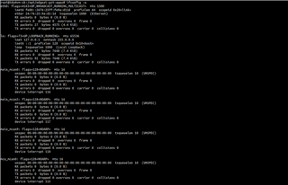

    I am facing same issue. I have modified the ti-processor-sdk-linux-edgeai-j721e-evm-09_02_00_05/board-support/ti-linux-kernel-6.1.80+gitAUTOINC+2e423244f8-ti/arch/arm64/boot/dts/ti/k3-j721e-main.dtsi file for all the 13 CAN channels.
    main_mcan0: can@2701000 {
    		compatible = "bosch,m_can";
    		reg = <0x00 0x02701000 0x00 0x200>,
    		      <0x00 0x02708000 0x00 0x8000>;
    		reg-names = "m_can", "message_ram";
    		power-domains = <&k3_pds 156 TI_SCI_PD_EXCLUSIVE>;
    		clocks = <&k3_clks 156 0>, <&k3_clks 156 1>;
    		clock-names = "hclk", "cclk";
    		interrupts = <GIC_SPI 124 IRQ_TYPE_LEVEL_HIGH>,
    			     <GIC_SPI 125 IRQ_TYPE_LEVEL_HIGH>;
    		interrupt-names = "int0", "int1";
    		bosch,mram-cfg = <0x0 128 64 64 64 64 32 32>;
    		status = "enable";
    After running "make linux-dtbs". I have copied all the dtb to /boot/dtb/ti/ in TDA4.
    But still CAN channels are not visible.

  • Hi Abdul,
    Try applying the patches in this E2E: https://e2e.ti.com/support/processors-group/processors/f/processors-forum/1334615/processor-sdk-j721e-can-driver-support-needed-for-a72-linux-of-processor-sdk-linux-sk-tda4vm/5119410?tisearch=e2e-sitesearch&keymatch=j721e%20can#5119410
    9.1 and 9.2 SDK are both based off of Linux kernel 6.1 version, so the patch should still apply.
    Let me know if you still see issues after applying this patch, and also send complete "dmesg" log after patch is applied.
    Takuma
  • Hi Takuma,
    Thank you for the prompt reply. The patch worked but I still have to test CANFD communication.
    I have another question. How can I change names to CAN0, CAN1, CAN3, CAN4 as it was before.
    Please find dmesg.txt

    [    1.121080] k3-ringacc 3c000000.ringacc: dma-ring-reset-quirk: disabled
    [    1.127839] k3-ringacc 3c000000.ringacc: RA Proxy rev. 66346100, num_proxies:64
    [    1.135788] 40a00000.serial: ttyS1 at MMIO 0x40a00000 (irq = 193, base_baud = 6000000) is a 8250
    [    1.145248] 2800000.serial: ttyS2 at MMIO 0x2800000 (irq = 194, base_baud = 3000000) is a 8250
    [    1.154097] printk: console [ttyS2] enabled
    [    1.162540] printk: bootconsole [ns16550a0] disabled
    [    1.172952] 2810000.serial: ttyS3 at MMIO 0x2810000 (irq = 195, base_baud = 3000000) is a 8250
    [    1.182929] davinci_mdio 46000f00.mdio: Configuring MDIO in manual mode
    [    1.228195] davinci_mdio 46000f00.mdio: davinci mdio revision 9.7, bus freq 1000000
    [    1.236867] davinci_mdio 46000f00.mdio: phy[0]: device 46000f00.mdio:00, driver TI DP83867
    [    1.245140] am65-cpsw-nuss 46000000.ethernet: initializing am65 cpsw nuss version 0x6BA00101, cpsw version 0x6BA80100 Ports: 2 quirks:00000000
    [    1.257948] am65-cpsw-nuss 46000000.ethernet: initialized cpsw ale version 1.4
    [    1.265155] am65-cpsw-nuss 46000000.ethernet: ALE Table size 64
    [    1.271438] am65-cpsw-nuss 46000000.ethernet: CPTS ver 0x4e8a010a, freq:500000000, add_val:1 pps:0
    [    1.281768] am65-cpts 310d0000.cpts: CPTS ver 0x4e8a010a, freq:200000000, add_val:4 pps:0
    [    1.295841] omap-mailbox 31f80000.mailbox: omap mailbox rev 0x66fc7100
    [    1.302685] omap-mailbox 31f81000.mailbox: omap mailbox rev 0x66fc7100
    [    1.309482] omap-mailbox 31f82000.mailbox: omap mailbox rev 0x66fc7100
    [    1.316292] omap-mailbox 31f83000.mailbox: omap mailbox rev 0x66fc7100
    [    1.323064] omap-mailbox 31f84000.mailbox: omap mailbox rev 0x66fc7100
    [    1.337245] ti-udma 285c0000.dma-controller: Channels: 26 (tchan: 13, rchan: 13, gp-rflow: 8)
    [    1.347924] ti-udma 31150000.dma-controller: Channels: 122 (tchan: 61, rchan: 61, gp-rflow: 16)
    [    1.362414] spi-nor spi0.0: s28hs512t (65536 Kbytes)
    [    1.367458] 8 fixed-partitions partitions found on MTD device 47040000.spi.0
    [    1.374494] Creating 8 MTD partitions on "47040000.spi.0":
    [    1.379979] 0x000000000000-0x000000080000 : "ospi.tiboot3"
    [    1.386094] 0x000000080000-0x000000280000 : "ospi.tispl"
    [    1.391873] 0x000000280000-0x000000680000 : "ospi.u-boot"
    [    1.397713] 0x000000680000-0x0000006c0000 : "ospi.env"
    [    1.403306] 0x0000006c0000-0x0000007c0000 : "ospi.sysfw"
    [    1.409091] 0x0000007c0000-0x000000800000 : "ospi.env.backup"
    [    1.415319] 0x000000800000-0x000003fc0000 : "ospi.rootfs"
    [    1.421179] 0x000003fc0000-0x000004000000 : "ospi.phypattern"
    [    1.431714] davinci_mdio 46000f00.mdio: Configuring MDIO in manual mode
    [    1.476195] davinci_mdio 46000f00.mdio: davinci mdio revision 9.7, bus freq 1000000
    [    1.484856] davinci_mdio 46000f00.mdio: phy[0]: device 46000f00.mdio:00, driver TI DP83867
    [    1.493128] am65-cpsw-nuss 46000000.ethernet: initializing am65 cpsw nuss version 0x6BA00101, cpsw version 0x6BA80100 Ports: 2 quirks:00000000
    [    1.505937] am65-cpsw-nuss 46000000.ethernet: initialized cpsw ale version 1.4
    [    1.513144] am65-cpsw-nuss 46000000.ethernet: ALE Table size 64
    [    1.519393] am65-cpsw-nuss 46000000.ethernet: CPTS ver 0x4e8a010a, freq:500000000, add_val:1 pps:0
    [    1.529822] am65-cpsw-nuss 46000000.ethernet: set new flow-id-base 48
    [    1.538385] mmc1: CQHCI version 5.10
    [    1.553614] ALSA device list:
    [    1.556589]   No soundcards found.
    [    1.580740] mmc1: SDHCI controller on 4fb0000.mmc [4fb0000.mmc] using ADMA 64-bit
    [    1.588331] Waiting for root device PARTUUID=a8f772c7-02...
    [    1.642663] mmc1: new ultra high speed DDR50 SDHC card at address aaaa
    [    1.649617] mmcblk1: mmc1:aaaa SC32G 29.7 GiB
    [    1.658589]  mmcblk1: p1 p2
    [    1.691756] EXT4-fs (mmcblk1p2): mounted filesystem with ordered data mode. Quota mode: none.
    [    1.700315] VFS: Mounted root (ext4 filesystem) on device 179:2.
    [    1.709859] devtmpfs: mounted
    [    1.713884] Freeing unused kernel memory: 1984K
    [    1.718514] Run /sbin/init as init process
    [    1.722605]   with arguments:
    [    1.722607]     /sbin/init
    [    1.722608]   with environment:
    [    1.722610]     HOME=/
    [    1.722611]     TERM=linux
    [    1.939726] systemd[1]: System time before build time, advancing clock.
    [    1.989541] NET: Registered PF_INET6 protocol family
    [    1.995099] Segment Routing with IPv6
    [    1.998781] In-situ OAM (IOAM) with IPv6
    [    2.027661] systemd[1]: systemd 250.5+ running in system mode (+PAM -AUDIT -SELINUX -APPARMOR +IMA -SMACK +SECCOMP -GCRYPT -GNUTLS -OPENSSL +ACL +BLKID -CURL -ELFUTILS -FIDO2 -IDN2 -IDN -IPTC +KMOD -LIBCRYPTSETUP +LIBFDISK -PCRE2 -PWQUALITY -P11KIT -QRENCODE -BZIP2 -LZ4 -XZ -ZLIB +ZSTD -BPF_FRAMEWORK -XKBCOMMON +UTMP +SYSVINIT default-hierarchy=hybrid)
    [    2.059102] systemd[1]: Detected architecture arm64.
    [    2.116335] systemd[1]: Hostname set to <tda4vm-sk>.
    [    2.207426] systemd-sysv-generator[142]: SysV service '/etc/init.d/thermal-zone-init' lacks a native systemd unit file. Automatically generating a unit file for compatibility. Please update package to include a native systemd unit file, in order to make it more safe and robust.
    [    2.232374] systemd-sysv-generator[142]: SysV service '/etc/init.d/edgeai-launcher.sh' lacks a native systemd unit file. Automatically generating a unit file for compatibility. Please update package to include a native systemd unit file, in order to make it more safe and robust.
    [    2.367581] systemd[1]: /lib/systemd/system/bt-enable.service:9: Standard output type syslog is obsolete, automatically updating to journal. Please update your unit file, and consider removing the setting altogether.
    [    2.411066] systemd[1]: /etc/systemd/system/sync-clocks.service:11: Standard output type syslog is obsolete, automatically updating to journal. Please update your unit file, and consider removing the setting altogether.
    [    2.462345] systemd[1]: Queued start job for default target Graphical Interface.
    [    2.501653] systemd[1]: Created slice Slice /system/getty.
    [    2.525629] systemd[1]: Created slice Slice /system/modprobe.
    [    2.549554] systemd[1]: Created slice Slice /system/serial-getty.
    [    2.573262] systemd[1]: Created slice User and Session Slice.
    [    2.596414] systemd[1]: Started Dispatch Password Requests to Console Directory Watch.
    [    2.620334] systemd[1]: Started Forward Password Requests to Wall Directory Watch.
    [    2.644385] systemd[1]: Reached target Path Units.
    [    2.660247] systemd[1]: Reached target Remote File Systems.
    [    2.680246] systemd[1]: Reached target Slice Units.
    [    2.696254] systemd[1]: Reached target Swaps.
    [    2.746983] systemd[1]: Listening on RPCbind Server Activation Socket.
    [    2.768332] systemd[1]: Reached target RPC Port Mapper.
    [    2.793080] systemd[1]: Listening on Process Core Dump Socket.
    [    2.816426] systemd[1]: Listening on initctl Compatibility Named Pipe.
    [    2.840578] systemd[1]: Listening on Journal Audit Socket.
    [    2.860492] systemd[1]: Listening on Journal Socket (/dev/log).
    [    2.880506] systemd[1]: Listening on Journal Socket.
    [    2.896578] systemd[1]: Listening on Network Service Netlink Socket.
    [    2.920566] systemd[1]: Listening on udev Control Socket.
    [    2.940438] systemd[1]: Listening on udev Kernel Socket.
    [    2.960466] systemd[1]: Listening on User Database Manager Socket.
    [    3.000498] systemd[1]: Mounting Huge Pages File System...
    [    3.018955] systemd[1]: Mounting POSIX Message Queue File System...
    [    3.042913] systemd[1]: Mounting Kernel Debug File System...
    [    3.060467] systemd[1]: Kernel Trace File System was skipped because of a failed condition check (ConditionPathExists=/sys/kernel/tracing).
    [    3.078320] systemd[1]: Mounting Temporary Directory /tmp...
    [    3.099645] systemd[1]: Starting Create List of Static Device Nodes...
    [    3.122765] systemd[1]: Starting Load Kernel Module configfs...
    [    3.142838] systemd[1]: Starting Load Kernel Module drm...
    [    3.163112] systemd[1]: Starting Load Kernel Module fuse...
    [    3.176543] fuse: init (API version 7.37)
    [    3.212721] systemd[1]: Starting Start psplash boot splash screen...
    [    3.239962] systemd[1]: Starting RPC Bind...
    [    3.256467] systemd[1]: File System Check on Root Device was skipped because of a failed condition check (ConditionPathIsReadWrite=!/).
    [    3.273097] systemd[1]: Starting Journal Service...
    [    3.288885] systemd[1]: Starting Load Kernel Modules...
    [    3.307816] systemd[1]: Starting Generate network units from Kernel command line...
    [    3.322556] cryptodev: loading out-of-tree module taints kernel.
    [    3.329990] cryptodev: driver 1.12 loaded.
    [    3.356740] systemd[1]: Starting Remount Root and Kernel File Systems...
    [    3.374799] EXT4-fs (mmcblk1p2): re-mounted. Quota mode: none.
    [    3.384250] systemd[1]: Starting Coldplug All udev Devices...
    [    3.413298] systemd[1]: Started RPC Bind.
    [    3.436776] systemd[1]: Started Journal Service.
    [    3.772328] systemd-journald[158]: Received client request to flush runtime journal.
    [    3.962718] audit: type=1334 audit(1651167747.020:2): prog-id=5 op=LOAD
    [    3.969693] audit: type=1334 audit(1651167747.028:3): prog-id=6 op=LOAD
    [    4.449363] random: crng init done
    [    4.473294] j721e-pcie-host 2900000.pcie: host bridge /bus@100000/pcie@2900000 ranges:
    [    4.485633] j721e-pcie-host 2900000.pcie:       IO 0x0010001000..0x0010010fff -> 0x0010001000
    [    4.495070] j721e-pcie-host 2900000.pcie:      MEM 0x0010011000..0x0017ffffff -> 0x0010011000
    [    4.504329] j721e-pcie-host 2900000.pcie:   IB MEM 0x0000000000..0xffffffffffff -> 0x0000000000
    [    4.522968] CAN device driver interface
    [    4.536010] mc: Linux media interface: v0.10
    [    4.611792] PVR_K:  191: Device: 4e20000000.gpu
    [    4.616772] PVR_K:  191: Read BVNC 22.104.208.318 from HW device registers
    [    4.633632] PVR_K:  191: RGX Device registered with BVNC 22.104.208.318
    [    4.641051] videodev: Linux video capture interface: v2.00
    [    4.656889] [drm] Initialized pvr 23.3.6512818 20170530 for 4e20000000.gpu on minor 0
    [    4.690735] k3-dsp-rproc 4d80800000.dsp: assigned reserved memory node vision-apps-c66-dma-memory@a9000000
    [    4.730134] k3-dsp-rproc 4d80800000.dsp: configured DSP for IPC-only mode
    [    4.740044] cdns-mhdp8546 a000000.dp-bridge: invalid resource
    [    4.760007] cdns-mhdp8546 a000000.dp-bridge: Failed to get SAPB memory resource, HDCP not supported
    [    4.794423] remoteproc remoteproc0: 4d80800000.dsp is available
    [    4.846621] remoteproc remoteproc0: attaching to 4d80800000.dsp
    [    4.855455] img_enc 4200000.video-encoder: vxe_enc_probe: using heap 1 for internal alloc
    [    4.883605] k3-dsp-rproc 4d80800000.dsp: DSP initialized in IPC-only mode
    [    4.891665] rproc-virtio rproc-virtio.0.auto: assigned reserved memory node vision-apps-c66-dma-memory@a9000000
    [    4.913285] virtio_rpmsg_bus virtio0: rpmsg host is online
    [    4.919037] virtio_rpmsg_bus virtio0: creating channel rpmsg_chrdev addr 0xd
    [    4.920520] rproc-virtio rproc-virtio.0.auto: registered virtio0 (type 7)
    [    4.933814] remoteproc remoteproc0: remote processor 4d80800000.dsp is now attached
    [    4.946171] k3-dsp-rproc 4d80800000.dsp: register pm nitifiers in remoteproc mode
    [    4.955903] k3-dsp-rproc 4d81800000.dsp: assigned reserved memory node vision-apps-c66-dma-memory@a8000000
    [    4.974687] img_dec 4300000.video-decoder: decoder registered as /dev/video0
    [    4.990964] img_enc 4200000.video-encoder: encoder registered as /dev/video1
    [    5.135061] k3-dsp-rproc 4d81800000.dsp: configured DSP for IPC-only mode
    [    5.169906] audit: type=1334 audit(1651199328.728:4): prog-id=7 op=LOAD
    [    5.180640] audit: type=1334 audit(1651199328.736:5): prog-id=8 op=LOAD
    [    5.197577] remoteproc remoteproc1: 4d81800000.dsp is available
    [    5.203702] remoteproc remoteproc1: attaching to 4d81800000.dsp
    [    5.210643] k3-dsp-rproc 4d81800000.dsp: DSP initialized in IPC-only mode
    [    5.221610] rproc-virtio rproc-virtio.1.auto: assigned reserved memory node vision-apps-c66-dma-memory@a8000000
    [    5.232394] virtio_rpmsg_bus virtio1: rpmsg host is online
    [    5.235720] virtio_rpmsg_bus virtio1: creating channel rpmsg_chrdev addr 0xd
    [    5.239721] rproc-virtio rproc-virtio.1.auto: registered virtio1 (type 7)
    [    5.251941] remoteproc remoteproc1: remote processor 4d81800000.dsp is now attached
    [    5.260367] k3-dsp-rproc 4d81800000.dsp: register pm nitifiers in remoteproc mode
    [    5.297291] k3-dsp-rproc 64800000.dsp: assigned reserved memory node vision-apps-c71-dma-memory@b2000000
    [    5.366478] k3-dsp-rproc 64800000.dsp: configured DSP for IPC-only mode
    [    5.381081] remoteproc remoteproc2: 64800000.dsp is available
    [    5.389530] remoteproc remoteproc2: attaching to 64800000.dsp
    [    5.441953] remoteproc remoteproc2: unsupported resource 65538
    [    5.450815] k3-dsp-rproc 64800000.dsp: DSP initialized in IPC-only mode
    [    5.459000] rproc-virtio rproc-virtio.2.auto: assigned reserved memory node vision-apps-c71-dma-memory@b2000000
    [    5.471513] virtio_rpmsg_bus virtio2: rpmsg host is online
    [    5.477167] virtio_rpmsg_bus virtio2: creating channel rpmsg_chrdev addr 0xd
    [    5.485545] rproc-virtio rproc-virtio.2.auto: registered virtio2 (type 7)
    [    5.494087] remoteproc remoteproc2: remote processor 64800000.dsp is now attached
    [    5.509702] k3-dsp-rproc 64800000.dsp: register pm nitifiers in remoteproc mode
    [    5.569337] j721e-pcie-host 2900000.pcie: PCI host bridge to bus 0000:00
    [    5.616283] pci_bus 0000:00: root bus resource [bus 00-ff]
    [    5.623259] pci_bus 0000:00: root bus resource [io  0x0000-0xffff] (bus address [0x10001000-0x10010fff])
    [    5.633323] pci_bus 0000:00: root bus resource [mem 0x10011000-0x17ffffff]
    [    5.640791] pci 0000:00:00.0: [104c:b00d] type 01 class 0x060400
    [    5.647310] pci_bus 0000:00: 2-byte config write to 0000:00:00.0 offset 0x4 may corrupt adjacent RW1C bits
    [    5.649910] Bluetooth: Core ver 2.22
    [    5.657616] pci 0000:00:00.0: supports D1
    [    5.670069] pci 0000:00:00.0: PME# supported from D0 D1 D3hot
    [    5.671556] NET: Registered PF_BLUETOOTH protocol family
    [    5.682216] pci 0000:00:00.0: bridge configuration invalid ([bus 00-00]), reconfiguring
    [    5.696929] pci_bus 0000:01: busn_res: [bus 01-ff] end is updated to 01
    [    5.704206] Bluetooth: HCI device and connection manager initialized
    [    5.715246] Bluetooth: HCI socket layer initialized
    [    5.722162] pci 0000:00:00.0: PCI bridge to [bus 01]
    [    5.727331] Bluetooth: L2CAP socket layer initialized
    [    5.732493] Bluetooth: SCO socket layer initialized
    [    5.779067] platform 41000000.r5f: R5F core may have been powered on by a different host, programmed state (0) != actual state (1)
    [    5.781601] m_can_platform 40528000.can: m_can device registered (irq=627, version=32)

  • Hi Takuma,
    mcu_mcan0 is not working and there is no rx, tx communication on this channel. Can you please provide the solution?
  • Hi Abdul,
    Please initialize all 4 CAN devices and try sending on all 4. It could be an issue with enumeration.
    Takuma
  • Hi Takuma,
    I have initialized all the 4 CAN channels and receive from all of them. main CAN channels are working fine. However, mcu_mcan0 is not receiving and I can see bus error from the sender side
    Debug port:
    root@tda4vm-sk:/opt/edgeai-gst-apps# [  133.179469] IPv6: ADDRCONF(NETDEV_CHANGE): mcu_mcan0: link becomes ready
    [  143.915629] IPv6: ADDRCONF(NETDEV_CHANGE): main_mcan0: link becomes ready
    [  150.636383] IPv6: ADDRCONF(NETDEV_CHANGE): main_mcan5: link becomes ready
    [  162.475369] IPv6: ADDRCONF(NETDEV_CHANGE): main_mcan9: link becomes ready
    [  371.431659] can: controller area network core
    [  371.436093] NET: Registered PF_CAN protocol family
    [  371.447894] can: raw protocol
    Terminal:
    root@tda4vm-sk:/opt/edgeai-gst-apps# ip link set mcu_mcan0 up type can bitrate 500000
    root@tda4vm-sk:/opt/edgeai-gst-apps# ip link set main_mcan0 up type can bitrate 500000
    root@tda4vm-sk:/opt/edgeai-gst-apps# ip link set main_mcan5 up type can bitrate 500000
    root@tda4vm-sk:/opt/edgeai-gst-apps# ip link set main_mcan9 up type can bitrate 500000
    root@tda4vm-sk:/opt/edgeai-gst-apps# candump mcu_mcan0
    Nothing is printed on mcu_mcan0. However I can see output for the other CAN channels.
  • Hi Abdul,
    Understood. I will look into it, and thanks for trying out the patch. I suspect something might have changed in device tree for the mcu/wakeup domain.
    In the meantime, for your usecase, are you able to continue with your development using main_mcans? Or is mcu_mcan a necessity?

    I need mcu_mcan aswell. Can you please speedup the process?
    Abdul Rehman
  • Hi Abdul,
    It looks like mcu_mcan is working in 6.6 kernel used for our next SDK release. Patches are here: https://lore.kernel.org/all/20240430131512.1327283-1-b-padhi@ti.com/.
    However, porting this back to 6.1 kernel is proving to be slightly difficult - mainly issues with mcu_mcan. Will need some more time to root cause.
    Takuma
  • Hi Takuma,
    When are you planning to release the new sdk version? Shall I apply this patch to 9.02?
    Abdul Rehman
  • Hi Abdul,
    New SDK should come out around end of July. SDK 9.2, which uses 6.1 Linux kernel seems to have issues with mcu_mcan as you and I have both found.
    However, I have pulled the latest Linux kernel from here and can verify that this behavior is fixed: https://git.ti.com/cgit/ti-linux-kernel/ti-linux-kernel/tree/?h=ti-linux-6.6.y-cicd. Determining which extra commit fixed mcu_mcan is a bit hard, since I cannot find any particular commits with a message that looks to be related specifically to mcu_mcan. But, you could also pull in the latest from ti-linux-kernel repo if end of July cannot be waited on.
