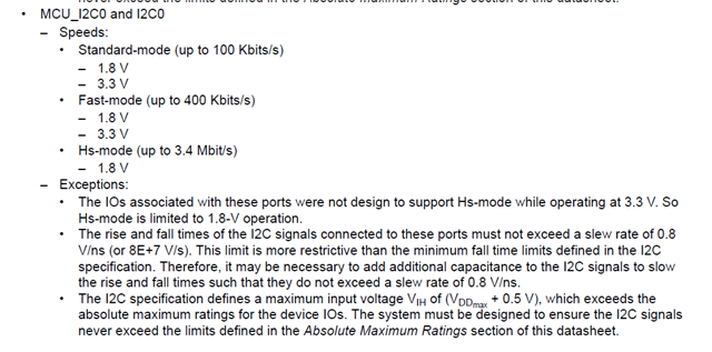

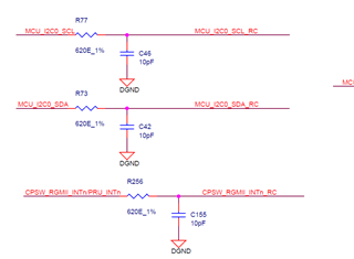

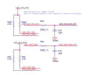

Can you please help me to understand the use case of 620E resistor on the following signal?
1) SoC_I2C0_SCL_RC
2) SoC_I2C0_SDA_RC
3) MCU_I2C0_SCL
4) MCU_I2C0_SDA
5) CPSW_RGMII_INTn/PRU_INTn

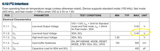

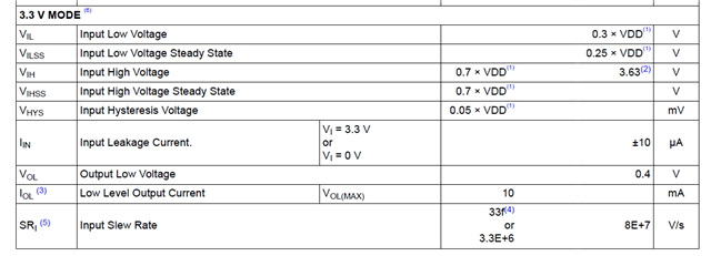

While capturing the waveform at SoC_I2C0_SCL, We come to know that device (TPS6522053RHBR) side low (base) voltage remaining 400mV as shown in below image.
According to section 6.12 I 2C Interface of TPS6522053RHBR datasheet. 400mV minimum required to detect the low pulse.
So,To improve the margin, Do you think it would be great if we reduce the 620E resistor to 100E?
