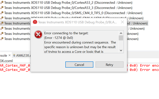

Hi TI team,
 We are facing the below error when connecting to target in AM62x_SK_EVM with JTAG interface in both on-board(XDS110) and external(XDS200) emulation.
  • Hello Muthuvel,
    Thanks for reaching out to Texas Instruments E2E support forum.
    Can you please confirm have you initialized the Board with SBL binaries?
    Please refer EVM_FLASH_SOC_INIT for more details.
    You will not be able to connect to a core if the EVM is not initialized properly.
    Tushar

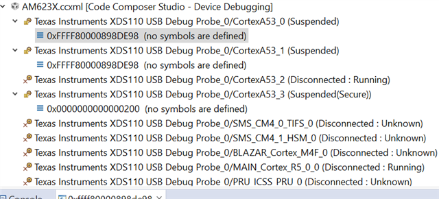

  • Hi Tushar,
    I can see that you have marked the thread as resolved.
    By mistake clicked resolved button. Unable to revert also.
    We already flashed our project program file in EVM board and it's working fine, also able to access all the ports.
    Currently we are trying to access AM62 through JTAG for debugging.
    We followed AM62x MCU+ SDK 09.02.01 guide to connect target but failed, please refer the below image.
    Also, we tried to program a basic Hello world program as per AM62x MCU+ SDK 09.02.01 guide, at that point we face this error.
    Hello world program file downloaded from project explorer -> MCU+ SDK for AM62x -> Examples -> hello_world
    still facing below error while connecting target..

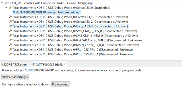

    1) Am I missing any files or procedure to be followed.
    2)Can we perform DDR4 full memory test using TMDSEMU560V2STM-U. We tired, couldn't be able to connect the target.
    We have seen one reference using XDS200 JTAG emulator to perform full memory test of DDR4 using CSS. Link
    Muthuvel K
  • Hello Muthuvel,
    Thanks for your response.
    Can you please share the target configuration file (*.ccxml)?
    Also can you please try the method suggested here? Please let us know the result.
    Tushar
  • Hi Tushar,
    Here BLAZAR_Cortex_M4F_1 was not found...
  • Hello Muthuvel,
    From the above error logs I can see that you are trying to load M4F core's example on A53 core which is causing the problem.
    Can you please try the below method and let me know if you still face any issues?
    Please refer below video.
    Tushar

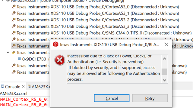

  • Hello Muthuvel,
    Can you please tell which boot mode are you using?
    Are you able to see the SBL logs when board is powered up or reset is done?
    Tushar
  • Hi Muthuvel,
    I can in the error logs you are having an openssl command error.
    Can you please install the openssl?  Please refer Open SSL for details.
    Tushar
  • Hi Tushar,
    After installation we are facing below error.
    thanks,
    Muthuvel K
  • Hi Tushar,
    We are using NOR flash Boot.
    Able to see log once powered up.
    Muthuvel K
  • Hello Muthuvel,
    Thanks for sharing the above information.
    Can you please confirm which debugger are you using (XDS110, XDS200, TMDSEMU560V2STM-U) ?
    As in your earlier replies I can see that you are trying to use the XDS200 debugger, but the above error logs says about XDS110 debugger.
    Please select the right configuration in your target configuration (*.ccxml) file.
    Tushar
  • Hi Tushar,
    We are tried with different debugger emulator but now trying with inbuilt xds110 on EVM
    Muthuvel K
  • Hi Tushar,
    configured xds110 and done Test connection also it shows Succeed.
    Muthuvel K
  • Hi Muthuvel,
    Thanks for the confirmation.
    Also can you please confirm when configured for XDS110 debugger, the EVM is not connected to the external XDS200 debugger?
    If an external debugger is connected with the EVM the onboard XDS110 debugger will not work.

  • Hi Tushar,
    R5 and A53 core target is connected.
    shall i try hello world with A53 core.
    Muthuvel K
  • Hello Muthuvel,
    Loading M4F core's example on A53 or R5F will not work.

  • Hi Tushar,
    connected A53 core and now facing "No verification error"
    but if want to change no verification on css tool 12.7 how to change ...
    in 12.7 Tool->Debugger option is not available
    0

  • Hello Muthuvel,
    As I already mentioned in my earlier reply that even after connecting to A53 core you will not be able to run M4F example on A53. You will need A53 examples to run it on A53 cores.

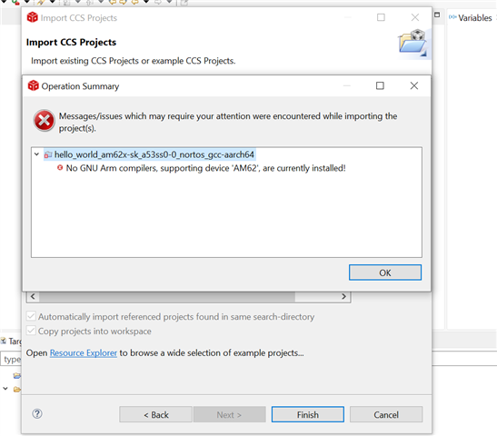

    While importing MCU-PLUS-SDK-AM62X  latest version facing below error.
    Muthuvel K
  • Hi Tushar,
    while Import latest a53 example facing below error.
    Muthuvel K
  • Hi Muthuvel,
    Can you please confirm, do you have GCC compiler installed at C:\ti?
    GCC AARCH64 compiler is required to do development on A53 cores.
    Please refer GCC_AARCH64_DOWNLOAD.
    Tushar
  • Hi Tushar,
    Still facing error..
    Muthuvel K
  • Hello Muthuvel,
    Please extract the *.tar file in C:\ti directory.
    You should have a similar folder as shown in below image.
    Tushar
  • Hi Tushar,
    Done.But still facing error
    Muthuvel K
  • Hi Muthuvel,
    Please follow below steps to add compiler to CCS.
    • Navigate to Windows -> Preferences
    • Under Preferences, go to Code Composer Studio -> Build -> Compilers.
    • Add the path of your GCC compiler as shown in above image.
    After doing the above steps, you should be able to import the example.
    Tushar
  • Hi Tushar,
    After OpenSSL installation post build error is cleared.

    now target is connected but in console seen GEL error.
    Muthuvel
  • Hi Muthuvel,
    In the target configuration file can you please check which GEL file is used for initialization?
    Please refer below image.
    Also can you please try using the below provided *.ccxml file and let me know the results?
    Target Configuration - AM62x_SK_EVM_XDS110.ccxml
    Tushar
  • Hi Tushar.
    Imported Above Target file.
    But still same error..
    Muthuvel K
  • Hello Muthuvel,
    I am not able to reproduce the issue at my end.
    Can you please provide the steps for replicating the issue at our end also?
    It is very difficult to support if the issue is not reproducible.
    I am using CCS v12.06.
    Tushar
  • Hi Tushar,
    A53 core was connected, disconnected, and then reconnected; this time, there was no Gel error.
    Is this Fine?
    Muthuvel K
  • Hello Muthuvel,
    Is this Fine?
    The output logs on the console looks okay to me.
    Are you able to load examples on A53 cores?
    Tushar
