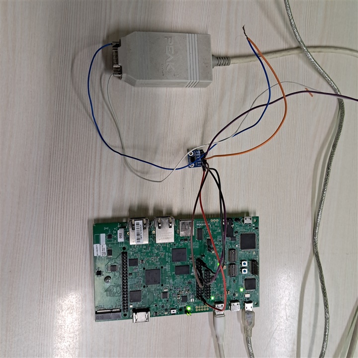

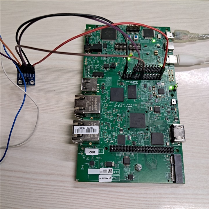

On the EVK, using main_mcan0 interface, I am able to send and receive CAN data. How do I use the other two interfaces(mcu_mcan0 and mcu_mcan1) for the same?
I have made the following connections:
TX(from external CAN transceiver) to Pin 22 of J9.
RX(from external CAN transceiver) to Pin 16 of J9.
Is there any other setup process needed for this? It would be great if someone can help me with this.
Sai Kiran.

    Yes, I have applied the dtbo on top of the SDK. Here is the snap of CAN messages in the dmesg.

    You are right, the following pins correspond to MCU_MCAN0:
    From the logs, can2 should drive MCU_MCAN0, could you test the same.

    I have made the connections as per the diagram. Using PCAN-View software, I am sending the data to EVK.
    However, using "candump mcu_mcan0" command, I do not see any CAN messages.
    Using the same setup, if I connect external CAN transceiver to main_mcan0 pins, I see the CAN messages when I run
    "candump main_mcan0" command.
    Sai Kiran.

    "candump mcu_mcan0" does not receive any data, even though the CAN messages are being sent.
    Sai Kiran.

  • Hi Aparna,
    I have checked the hardware connections. I do not see any issues. If there are any specific PINS you want me to check(for connectivity and voltage measurement), do let me know.
    Sai Kiran.

  • If you are using the latest SDK image, and applying the dtbo correctly, you don't need any other software changes. MCU MCANs should directly work.
    Please share the snapshop of your hardware connections.
    Aparna
  • Thanks,
    Sai Kiran.
  • Hello Sai,
    You are trying to power the CAN transceiver with the AM62x SK, but power rails on AM62x MCU header are not enabled by default.
    Could you try giving out 3.3 V supply from an alternate source?
    Aparna
  • Hi Aparna,
    In the existing setup, I have measures the voltage across CAN transceiver PINS. It is 3.3V.
    However as per your suggestion, I have provided external power supply of 3.3V. I have verified it with multimeter.
    Sai Kiran.
