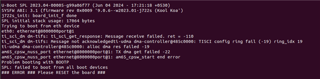

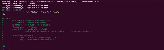

I am trying to boot the J722S EVM with Ethernet Boot Mode with the SDK version 9.02.
I have made the changes in the defconfig to support the ethboot as shown below:
I have observed the below logs:
Could you please guide me for the Ethernet Boot to work.
  • Ethboot defconfig changes as mentioned above:

    May I Know what you are trying to do?
    If you are expecting CPSW to be up at R5F SPL? you need to enable the clock and power from clk-data.c & dev.data.c from "u-boot/arch/arm/mach-k3/j722s/".
    But, above will not enable Ethernet Boot Mode.
    We haven't validated Ethernet Boot Mode yet. For this ROM code needs to support Ethernet functionality.
    Let me check internally and get back to you in next week.
    Sudheer
    Thanks for your response.
    We are working on the CPSW boot at R5F SPL.
    Could you please revert as soon as possible regarding the updates which needs to be taken care for the CPSW Boot.
    Vishnupriya J
    I have requested internally to provide the updated clk-data.c & dev-data.c files with CPSW enable.
    Once I will receive the updated files, will share it with you.
    FYI,
    We have not tested/validated CPSW enable at SPL stage.
    Sudheer
    Thanks for the speedy response.
    Once the clk-data.c and dev-data.c files are available, we will validate the CPSW at SPL stage.
    Vishnupriya J

    As informed earlier, we have not validated/tested CPSW at SPL stage.
    Sudheer
  • Hi Sudheer,
    We have added the clock and power domain files which you have shared. Still the same issue persists. We are debugging on this issue.
    Could you please help me to know any other files needs to be taken care for the CPSW Boot support.
    Vishnupriya J
    If you want to boot CPSW at SPL stage you need to update the defconfig of R5F also, need to add the CPSW nodes in r5-evm.dts files.
    You can check with above changes.
    Sudheer
  • Hi Sudheer,
    I have updated the below changes for the r5 and a53 dts entries as shown below:
    Change in the k3-j722s-evm-u-boot.dtsi
    Change in the k3-j722s-r5-evm.dts
    Changes in the a53 dts file (k3-j722s-evm.dts)
    Also I have updated in the j722s_init.c file also as shown below:
    After making those changes along with the defconfig changes and the clock and the power domain changes that have shared by you I have observed the below logs for the Ethernet Boot, where the Ethernet driver itself is not able to load.
    Could you please guide how to resolve the issue which I am debugging now.
    Vishnupriya J
    Let me check once internally about this and update you.
    As it is not validated at TI side, and default SDK not supported this.
    Sudheer

  • Hi Sudheer,
    We are using CPSW at U-Boot stage. We were able to make some progress and the CPSW drivers are enumerated. However we are getting the below error:
    Looks like we need to update the tifs/rm yaml files in the SPL. But we are unsure of the changes. Could you please guide us on the same?

  • Hi Sudheer,
    We updated the sources by referring to the AM62 patches provided by you. However, we are still facing the same issue.
    Could you please guide us on this?
    Vishnupriya J
    Have you added all dependent nodes of CPSW into device tree? like PSIL thread map.. and other if any,
    Also, make sure that enabling of all dependent modules from defconfig.
