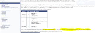

    Yes, CPSW9G has Max of 8 Tx channels allowed with UDMA using PSIL threads.
    Out of 8, 3 are using in EthFw So, client can use Max of 5. If we remove MAC only Ports we can increase to 5 clients. But, Ethfw has virtual Switch Port numbers are defined to 4 from "EthRemoteCfg_VirtPort_e" (reason might be other SoCs may not have MCU4_0 and MCU4_1 cores, also few are MAC only Ports which also will use resources)
    Please refer to User Guide for more details.
    If you want 5th virtual switch client you can add Switch Port Macro in "EthRemoteCfg_VirtPort_e"  at end and use it, same to be used in clients as well.
    Sudheer

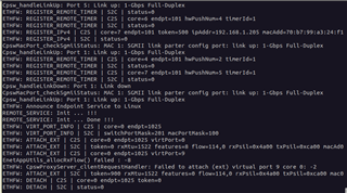

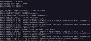

    I get those errors on A72 and mcu2_0 server display:
    As you can see the A72 doesn't work too. It's weird because the A72 tried to add a new virtport 9 but I never asked him to do that. It's seems like there is a memory conflict between the new born switch_port_4 and the A72 setup.
    I don't know if you have more information on your side, if that the case I'm eager to hear that.
    It seems like you have enabled MAC Only Port mapping to A72 client (MPU1_0) under "gEthApp_allocCfg".
    Can you check by Disabling MAC Only Macro (ENABLE_MAC_ONLY_PORTS) itself.
    Sudheer
    Yes I already commented the ENABLE_MAC_ONLY_PORTS macro in concerto.mak files, so it's weird that it try to enable a MAC port. I tried to run the program by commenting the .virtMacPortMask in gEthApp_allocCfg too but it's the same error.

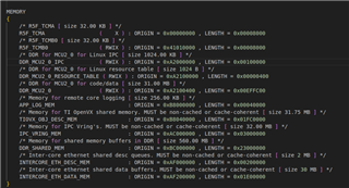

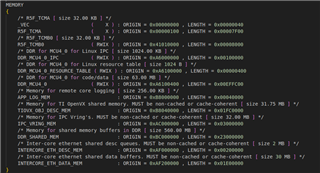

    I allocated the client mcu4_0 in the A6000000 adresses maybe it's link to that...
    Below is the screen of the memory map of the mcu2_0 and mcu3_1
    On the other hand I tried to add the switch_port_4 with the changes evoqued before without adding the mcu4_0. I get a different error linked to the switch port :
    So it's seems that adding a new client bring conflict with the A72 core, and adding the switch port with the changes I described before doesn't work.

    I didn't give you the patch file from a branch with all the modications because it may be too big to review for the issue I encounter.
    From what I have tested it seems adding the mcu4_0 client with the memory allocation I defined doesn't cause any issue as long as I stay at 4 clients (my clients were : mcu2_1, mcu3_0, mcu4_0, A72, and when I had a 5th client like the mcu3_1, the A72 try to connect a virtport 9 as shown before). Maybe it's because the 5th client is suppose to be connected with the Tx channel of the initial virtual mac port of the A72, and it's still connected even if I have disable the mac port.
    I control the channel allocation for the mcu2_0 with the ethfw_api.c file. Then adding the clients in the mcu2_0 allocate dynamically the channels to the adresses specified.
    Matthias
    May I know your use-case of having multiple ethernet clients? As TI SDK is not supporting multiple clients more than 4.
    Sudheer
    We headed toward the TDA4VH soc because it has a 9 ports switch to connect more than 4 items to the switch, and we need the same amount of processors connected to treat those items.
    Do you know the reason why the SDK doesn't support more thant 4 clients ? Is it a software issue that we can solve on our own or it's precompiled files or HW issues ?
    Thank you.
    Matthias
    From SDK and User Manual we have reserved Tx channels for specific use on each core (server & clients).
    So, as per the resources usage SDK enabled only 3 client cores with MAC Only and Switch.
    It may not be an HW Issue, It will most likely SW Issue.
    Sudheer
    Can you provide more information from the SDK team on what changes need to be made to have additional clients ?
    The issues seems to come from conflict with A72 sw on a Tx channel. And from the addition of more switch port. Maybe from the patch I provided, you could lead me on the additionnal changes needed to be made.
    Thank you in advance.
    Matthias
    Let me check internally once, and get back to you.
    Can you please add prints inside alloc_rx_flow and share the log, where it was failing.
