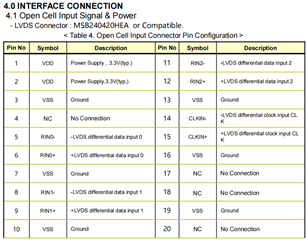

Currently, I am working on our custom board  and trying to activate LVDS CH1 (odd) port.  The sdk version is v9.02.
Previously, we had an RGB LCD screen that worked fine; now we need to use an LVDS single link 18bits LCD screen. The interface information is shown in the attached images. Referring to some articles on the forum, I have modified the DTS file and panel-simple.c as follows. However, the LVDS panel is not working properly and remains in bist mode.

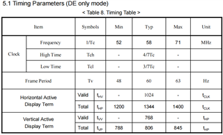

static const struct drm_display_mode boe_ev150x0m_mode = {
	.clock = 58000,
	.hdisplay = 1024,
	.hsync_start = 1024 + 80,
	.hsync_end = 1024 + 80+ 80,
	.htotal = 1024 + 80 + 80 + 40,
	.vdisplay = 768,
	.vsync_start = 768 + 10,
	.vsync_end = 768 + 10 + 10,
	.vtotal = 768 + 10 + 10 + 10,

I checked the clock signal using an oscilloscope and found that the actual clock frequency was only half of what I configured. Specifically, the configured frequency was 58MHz, but the actual measured frequency was around 29MHz. How can I resolve this issue and get the panel work.

    I don't think you need to double the clock and it should be programmed as 58000. Also, you htotal and vtotal does not add up to the LCD specs. Are you sure you programed the right values?
    Also, you mentioned the LCD worked previously and was it with our platform?
    Krunal

    1. I modified htotal and vtotal config as below,also it didn't work.
    	.clock = 58000,
    	.hdisplay = 1024,
    	.htotal = 1024 + 80 + 80 + 160,
    	.vdisplay = 768,
    	.vtotal = 768 + 10 + 10 + 18,

    2. Yes, I have another RGB interface LCD panel that is working fine on the same board. It is connected to another interface of the board.
    The panel still doesn't work properly.
    My configuration seems to be correct, but why is the output frequency only half of the set frequency? Could there be an issue with the driver? When using dual-link LVDS, the output frequency should be half of the set frequency, but when set to single-link, the driver is not correctly configured to the set value? Could you please help confirm this?
    This LVDS panel is being used on our AM335X board, where the RGB signal is converted into LVDS by an SN65LVDS84. I measured the clock frequency when it's working normally, and it's 58MHz, which shouldn't be half of the set value.

    I changed the configuration to the following with double clock and hdisplay,, and the panel is working properly now.
    	.clock = 116000,
    	.hdisplay = 2048,
    	.hsync_start = 2048 + 160,
    	.hsync_end = 2048 + 160+ 160,
    	.htotal = 2048 + 160 + 160 + 320,
    	.vdisplay = 768,
    	.vsync_start = 768 + 20,
    	.vsync_end = 768 + 20 + 20,
    	.vtotal = 768 + 20 + 20 + 36,
    Therefore, I believe the driver is working as dual-link instead of the expected single-link. When I configure it with double frequency and hdisplay, I get the desired 1024x768 configuration on LVDS1, with the image combined from odd (or even) pixel columns. Please help check why the driver is not working as single-link.

    I have confirmed with LCD verdorl that the values are suitable.
    Have you tested the frequency when configured as single-link?
    Huashan
