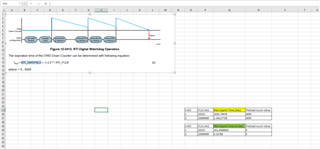

  • Hello Christopher Holland,
    Mostly SOC can use two frequencies for watchdog clock one is 32KHz and another one 25MHz.
    Please look at more clock selections for watchdog from the link below .
    https://dev.ti.com/sysconfig/#/config/?args=--product%20%2Fmnt%2Ftirex-content%2Fsitara_ctt_1_1_1%2F.metadata%2Fproduct.json%20--device%20AM64x%20--part%20Default%20--package%20ALV%20--context%20system
    So, in our MCU+SDK by default we are feeding a 32552KHz clock signal to Watchdog and for this you can only configure expired time in between from >251msec to 1031sec.
    If you feed a 25MHz clock signal, then you can configure to the expired time expire between >0.32msec to 1.34 sec.
    So, choose the WDT clock based on your requirements.
    I am sharing the same analysis document for your reference.
    Any other clock selections we don't support from system cfg. So, you need to take care manually.
    Actually, the code below can be helpful to how to configure the watchdog manually.
    In the code, you need to just change WDT clock frequency to 25MHz for your requirement.
    status = SOC_moduleSetClockFrequency( TISCI_DEV_MCU_RTI0,TISCI_DEV_MCU_RTI0_RTI_CLK,25000000);

    For testing purpose try to configure expired time to 520msec and see if you are able to get the watchdog interrupt or not .Since, this expire time should work as per our analysis .
    Anil.
