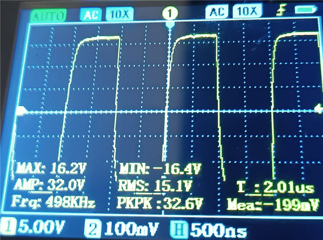

    I used the manual clear with shadow mode enabled. I was surprised that what worked was setting this register to 1.
         CT_IEP0.cmp_status_reg_bit.cmp_status = 1;
    We have been researching PTP and PPSs. That is what we'll try next, DTS is already in place.
    Also, a wave generated while counting for 1us with the IEP.
    Scope with wave generated with IEP timer
