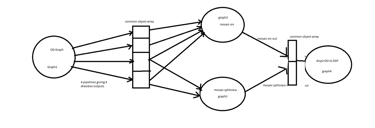

Graph1:
The OD graph(graph1) has four pipelines running in four different tasks each giving draw box detection output. The OD chain is as below
ldc1->msc1->preproc1->tidl1->drawbox1
ldc2->msc2->preproc2->tidl2->drawbox2
ldc3->msc3->preproc3->tidl3->drawbox3
ldc4->msc4->preproc4->tidl4->drawbox4
The four LDC images are coming from an another graph.
This graph is storing its output in a common object array as show in the diagram.
Graph2:
This is having only one node that is Mosaic node. Its job to mosaic the four images that are stored by graph1 and store its output in an object array on first position of it. This object array is common between graph2, graph3, graph4 as shown in the diagram.
Graph3:
Similar to graph2, only has one node that is mosaic node, mosaics two images instead of four and store the output in second position in the object array as shown in the diagram.
Graph4:
This graph is having only one node that is display node. This takes input of the two mosaic nodes stored by graph2 and graph3. The refs list size of this graph is 1 and ref list is the second common object array.

Note: When I comment one of the graph from graph2 and graph3 then the graph4 runs. It also switches the image just the image is blank only for one graph that is commented.
I am doubting its related to bufq depth but not sure.
Tried another design where I put both the mosaic nodes in the display graph but writing their output to the same object array gives a runtime error. "Two nodes of graph are trying to write the same edge".
How can I implement this to be able to switch between two mosaic outputs in display node ?

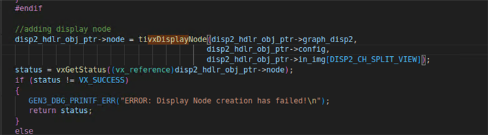

    Display Node creation:

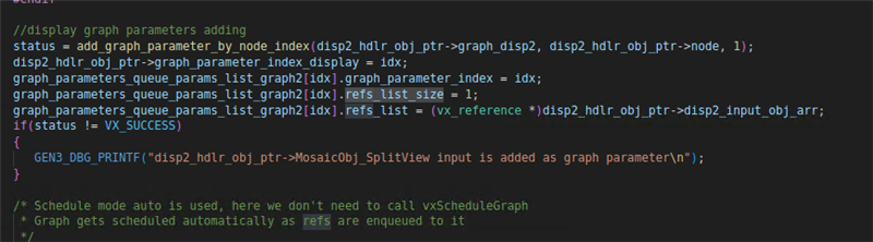

    Display graph refs_list:

    UPDATE: I have a really strange observation here. So, the display graph is stuck at dequeue but I can see the output on display. BUT, it is only that channels(Mosaic output) output which is passed to the tivxDisplayNode(). IT DOES NOT SWITCH.
    Case1: I pass disp2_hdlr_obj_ptr->in_img[DISP2_CH_SRV] as input image. The expected output displays on monitor and it is live view. Checked with moving the camera around. It is updating on the display. Not stuck or anything.
    Case2: Same as case1 I pass disp2_hdlr_obj_ptr->in_img[DISP2_CH_SPLITVIEW] now. It shows on the display as expected.
    How is this possible that graph is stuck at dequeue but I can see the output on the display ? When I disable the graph it doesn't show anything so I am sure that this graph only is giving the output to the display.

    If the display input in a graph parameter and the display graph is a separate graph with only display node in it, then as long as the application does not provide an image to the display node (i.e. enqueue) the display graph does not execute.
    In order to understand how this is happening, could you please review your application? Is it possible to share the same here?
