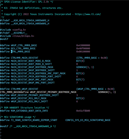

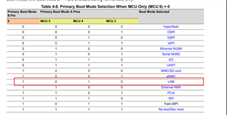

    As per the dev stat value is 0x00070310
    Lets map this to the boot mode as per the TRM
    CTRLMMR_WKUP_DEVSTAT[23:16] -> BOOTMODE pin
    CTRLMMR_WKUP_DEVSTAT[9:0] -> MCU_BOOTMODE pin
    In you case MCU_BOOTMODE pin value is 1100010000 and BOOT pin value is 00000111.
    Primary boot mode pin is 1 and mcu3,4,5 is (010)
    Diwakar

    We are having issue in OSPI boot mode
    As per below
    0x00060008 --> 00000000000001100000000000001000
    MCU_BOOTMODE --> 0000001000
    Boot pin  --> 00001100
    In above diagram for OSPI
    primary boot mode is 0 MCU 5,4 is 0 MCU 3 is 1  ==> 1000
    So I hope it match our boot mode
    When Board in OSPI boot mode, DFU cable connected TDA4 is not booting

  • From the bootmode settings provided, when configured for OSPI, the backup mode is SPI - thus USB is not in the boot sequence at all.
    Are the mcu and bootmode pins used for other functions?
    Anything additional information you can provide in failing case?  is the processor running/functional - just not booting from OSPI (or is it in reset or other)?

    No..
