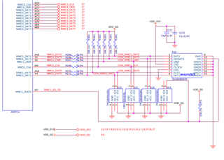

    below is design related to sd/mmc1

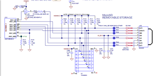

  • Hello Hanmant,
    Your mmc printout is very different then ours.
    Device: OMAP SD/MMC
    Manufacturer ID: 9f
    OEM: 5449
    Bus Speed: 24000000
    Mode: MMC legacy
    Rd Block Len: 512
    SD version 3.0
    High Capacity: Yes
    Capacity: 29.1 GiB
    Bus Width: 4-bit
    Erase Group Size: 512 Bytes
    => mmc list
    OMAP SD/MMC: 0 (SD)
    OMAP SD/MMC: 1 (eMMC)
    So I suspect your DT entry looks different than ours.
    Also, your design seems to not be following the schematic checklist
    Please see https://www.ti.com/lit/an/sprack7b/sprack7b.pdf#page=9
    "For SD-CARD implementations, 10K pull-up resistors are needed on all data signals and on the command signal."
    -Josue
  • HI Josue,
    Thanks for your answer .
    please confirm is it Ok to MMC1_DATA3 and MMC1_SDCD ?As in our design we have connected MMC1_DATA3 and MMC1_SDCD .
    I will replace  all signal with 10K pull-up resistors.
    Is there any idea or anything i need to change in u-boot code?
    Please suggest me to resolve.
    Hanmant
  • Hello Hanmant,
    I will need to double check with our HW engineers for :
    but based on our reference board, it seems like this could be ok ..
    Have you made any changes in U-boot from the base SDK?
    Can you share your DTS entries for SD card?
    -Josue
