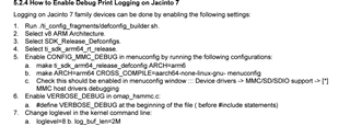

    thanks your reply.
    How to enable emmc debug log in j721s2 ??
  • Hi Terry
    You need to increase the linux kernel log level in the bootargs.
    Please refer:https://www.kernel.org/doc/html/v4.14/admin-guide/kernel-parameters.html
    Diwakar
  • How to check if emmc debug log has been successfully enabled?
  • Hi Terry
    One you increase the log level you should see more logs getting printed on the console even debug logs as well, you can grep for the mmc logs in the dmesg to analyse the issue.
