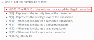

        We have currently enabled the NAVSS0_VIRTSS_NB_SLV2_MEM0 firewall, allowing only certain masters on the north bridge side to access the Linux system memory in TDA4VH. However, after enabling it, we captured many exception logs through the  WKUP UART(DMSC logs), such as:
FWLBit 0x1D
Exceptionaddr 0x45B0B800
FWLException 0x1141600
0x30000
0xE0120400
0x8
0x12E109A
0x8
Based on the following analysis:
We can find the illegal priv-ID 0x9A, but the "List of priv-ids" provided in the link below is not comprehensive enough.
J784S4 Firewall Descriptions — TISCI User Guide
Could you please provide complete priv-id information for TDA4VH?
