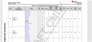

we need to configure the TRACE_CLK
1-The Register PADCONFIG_1 with address 0x4301C004 , I configured it as Output with value 10 to enable the CLK
2-The Register PADCONFIG_50 with 0x4301C0C8 , I configured it as Output with value 10 to enable the CLK
This is the right configuration or we need something else?

  • Hello Richard,
    I configured the Pins of the CLK as the following screenshot, but when I measured the PIN W25 on the SOC , I found that the PIN is HIGH all the time, there is no change , is there is an extra configuration I need to add it , to see the CLK pulses?
  • please see the channel D7
  • Hello Emad,
    On the TI-EVM there is a FET-MUX used to select between trace and alternate functions.  That MUX's initial state is set by a board DIP switch, but that value can be overridden by an I2C-GPIO-expander signal.  If you are testing on an EVM, you need to ensure the MUX select signal is correct.  If you are trying on your own board, and the connectivity matches the EVM, then you will need to also ensure the trace clock is active before you might see any transitions on the TRC_CLK line.  In general, the TPIU has a pattern generator which a debug box will activate to generate a test pattern to train against.  The checkout should be to setup the clocks, then setup any MUX routing (board level and SOC level), then use the tool to generate a test pattern.  You can probe the header to see the clock then, or you can use some tool level information to deduce if things are toggling.
