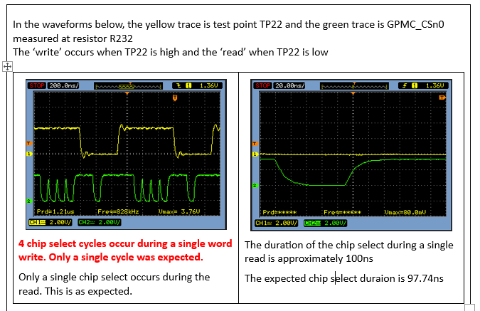

Using a hard coded GPMC configuration we are noticing that the GPMC is not performing as indicated on the AM64 Datasheet/Technical Reference Manual. We are using hardcoded GPMC values due to the limitations of the the Ti driver.
The chip select line seems to be over active on the writing.

    The read cycle is OK and the write cycle creates an issue.
    Your expectation is correct to write cycles CS is operating more cycles vs expected.

    Actually, read cycle approximately you got 97.8nasec, which should supposed to be 100nsec. I think this seems OK.
    One more thing is that, even with the above CS over operating in write cycles, still are you able to write and read operations properly?

    We are testing using the R5F core and the application is solely for GPMC testing. We are still able to read back what we are righting so it appears to be working even though the CS line does not appear to be working as intended.

    When you observe the additional CS activity, have you probed other signals such as WEn, OEn, and Byte Enables (BE1n, BE0n)
    I suspect some of the CS low pulses may not have any corresponding WEn or OEn low pulse. And byte enables may be high (not enabled).
    We have observed "phantom chip selects" coming out of the GPMC pins as an artifact of writes through different hardware interconnects with protocol wrappers - for example a 64-bit CBA bus to 32-bit OCP bus to 16-bit GPMC peripheral may generate some GPMC pin activity where CS goes low but WEn, OEn, and byte enables all stay high.
    This thread may be relevant: https://e2e.ti.com/support/processors-group/processors/f/processors-forum/316742/am335x-gpmc-phantom-chip-select-generation/1106520#1106520

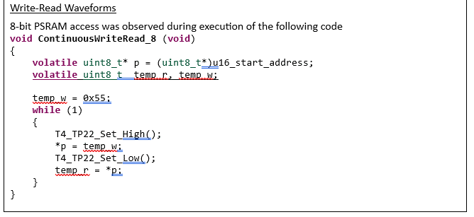

     - Try the asm(" DMB"); instruction after the write.
     - Read about and play with the memory management - https://developer.arm.com/documentation/ddi0333/h/memory-management-unit/memory-attributes-and-types
