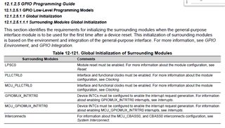

I have a question regarding GPIO configurations on the AM64x/AM64243x.
In the GPIO Programming Guide section of the reference manual (section 12.1.2.5), there is a Global Initialization sub section (12.1.2.5.1.1). The Table 12-121 describes the need to initialize tje surrounding modules before initializing any of the GPIOs. It talks about enabling the module reset and enabling the interface and functional clocks.
Can you please explain how and what registers need to be written to in order to configure those? I can't seem to find anything in the API that explains how to do this.
I inserted a picture of the table in question.
Thank you!

  • Hello Eden Abitbol,
    I am sure that you no need to control above registers since there is SSYFW is avialble on AM64X and which does all opeations setting PLL Clocks , setting operating frequency for diferent cores and periperhals ,resoucer allocations ,  reset and other security features will handle by the SYSFW and it run on M3 core .
    So, to use GPIO's you no need to controlany above registers and simply configure GPIO in input or ooupur or interrupt in Application or SBL from system cfg and it wil generated code to configure GPIO peripehrals registers other than this you no need to do anything .
    Please let me know if this helps your query .
    You can look at the image below all PLL setting has configured to all GPIO's in the SYSFW and you don't need to enable them again .
    So, to use GPIO's you don't need to control any above registers and simply configure the GPIO as input or output or interrupt in Application or SBL from system cfg, and it will generate code to configure GPIO peripherals registers other than this you no need to do anything.
    Please let me know if this helps your query.
