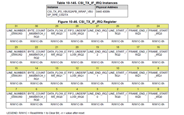

  • 1.The error reported by our competitor has been analyzed in detail as CSI frame loss, FIFO queue data is empty. Do we have any relevant processing experience and investigation direction
    2.The bits of the registers in the attached figure can indicate the loss of CSI frame header data and the empty FIFO queue data
    As mentioned above, the errors from the transmitting side can only be identified from the csirx receiver diagnostics, and you can check if it is a FIFO overflow, ecc error or crc error etc.
    Let me check internally again, if there are any error checker for CSITX
    Nikhil
    The errors obtained from csitx are
    Csitx_fifoUnderflow : Indicates Synchronization FIFO has underflowed. Caused by the rate at the PPI interface being higher than the data rate at the pixel interface
    Csitx_dataFlowErr : Caused by the system attempting to start a frame when the controller or D-PHY are not ready
    Csitx_byteCntMismatch : Indicates that the number of bytes received for a line on the pixel interface did not match the programmed word_count for the particular virtual channel.
    Csitx_lineNumberErr: Indicates that the number of lines received for a frame on the pixel interface exceeded the programmed max_line_number value for the particular virtual channel
    But these errors are checked before sending the data to DPHY, i.e. within the csitx controller.
    Anything, sent on the dphy should be checked at the csirx end.
