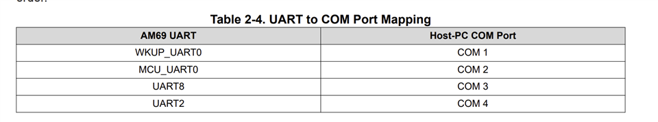

  • Current Progress and Issues with UART Booting
    Setup Details:
    1. PC Serial Ports:
    • My PC serial port is ttyUSB1-4
    • According to Table 2-4 in spruj70a.pdf (ti.com)
      • ttyUSB2 corresponds to MCU_UART
      • ttyUSB3 corresponds to UART8 (used for A72 debug)
    2. Boot Flows
    However, section 3.1.1.9 in 3.1.1.9. UART — Processor SDK Linux for AM69 Documentation indicates using only two files( tiboot3.bin and u-boot.img)and the same serial port

    MCU_UART0 is COM2. So i assume that COM2 --> ttyUSB2 & that is working as expected.
    Now the next Images should be transferred on MAIN_UART8 aka ttyUSB3.
    The CCCCCCC... appearing on ttyUSB3 is a clue for you to start transferring tispl.bin.
    That should be first transferred and then you will again get CCCCCCCC on ttyUSB3 and that is when you need to transfer u-boot.img.
    - Keerthy
