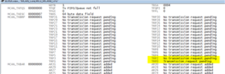

Hello TI support,
I am working with a simple demo can application to transmit a CAN frame cyclically on every 1second.
Interrupt based configuration and HW is not transmitting 1st frame which is requested to transmit.
Due to non transmission of 1st frame, consecutive frames are not getting transmitted and Can in BUSY state.
All Can_Write function requests are returned with Can Busy.
I have observed during debugging, Transmission request pending.
Could you please let me know, any pointers to debug and fix the issue.
Attached Can, Dio, & Mcu configuration files.
For the CAN PORT initialization, we have taken code from mcal demo.
Kind regards,
Hari

    May i know which SDK version is this?
    Tarun Mukesh
  • Hi Tarun,
    MCAL version is  MCUSW_09_00_00_15_CONFIG + sdk-rtos-j721e-evm-09_00_00_02.
    Kind regards,
    Hari
  • Hello Hari,
    We have fixed an issue in SDK 9.1 related to CAN busy .https://sir.ext.ti.com/jira/browse/EXT_EP-11521
    Can you check with SDK 9.1 if you are facing same issue ?
    Tarun Mukesh
  • Hello Tarun,
    Issue case is different here.
    1st Can message itself not transmitting.
    Can driver is not triggering/transmitting a msg after Can_Write.
    At step 3 normally CAN msg will be triggered/transmitted.
    What could problem here if msg  triggered/transmitted?
    What are the points need to be checked here?
    Kind regards,
    Hari
  • Hello Hari,
    CAN_Write will call internally CAN_WriteTxMailbox and then followed by MCAN_txBufAddReq then CAN msg will be transmitted.
    1. CAN_Write:This function checks if the transmit mailbox is available to send data.If the TX MB is free, it fills the TX MB with the data and initiates the transmission1.
    2. CAN_WriteTxMailbox:This internal function is likely responsible for handling the actual transmission of the message from the TX MB.It interacts with the hardware to put the message on the CAN bus.
    3. MCAN_txBufAddReq:This function initiates the transmission request for a specific buffer (TX MB or FIFO).
    The possible reasons can be as below mentioned:
    1. Hardware Configuration:Verify that the CAN controller is correctly configured.Check the bit rate, frame format (standard or extended), and other relevant settings.Ensure that the CAN transceiver is properly connected and powered.
    2. Buffer Availability:Confirm that the transmit buffer (TX MB or FIFO) is available for transmission.If using a FIFO, check the fill level. If it’s full, wait until there’s space.If using TX MBs, ensure that the desired mailbox is free.
    3. Message Data:Double-check the data you’re trying to transmit.Ensure that the message ID  and data length are correct.Validate the data payload itself.
    4. Error Handling:Look for error codes or flags in the MCAN status registers.Common errors include bus-off conditions, arbitration lost, or frame errors.Clear any error flags before attempting transmission.
    5. Transmission Request Timing:Make sure you’re invoking MCAN_txBufAddReq at the appropriate time.f you’re sending multiple packets, ensure that you wait for the previous transmission to complete before adding the next packet.
    6. Interrupts and Callbacks:Check if there are any interrupt handlers or callbacks related to message transmission.Ensure that they’re correctly configured and invoked.
    7. Bus Activity:Monitor the CAN bus using an PCAN or CANoe.Verify that other nodes on the bus are active and not causing issues.
    Tarun Mukesh
  • Hello Tarun,
    Is it possible to have a shot debug session tomorrow at or after 1pm IST?
    Could be helpful, to solve issue directly.
    Kind regards,
    Hari
  • Hello Hari,
    Having debug session is not possible due to pre commitments over the week. We have can_app example, can_profile_app example in our SDK, could you please refer that  for assistance ?
    Tarun Mukesh
  • Hi Tarun,
    We have an observation of Clock & PLL initialization with Mcu module.
    Peripheral clock configuration in Mcu module is not executed and seems Mcu is not fully implemented.
    In Mcal Can demo app, Power and Clock initialization is done by GEL scripts.
    GEL scripts are useful only if CCS is used.
    Please confirm above understanding is correct, and correct me if i am wrong.
    Could you please provide a Can demo with fully configured Mcu module.
    i.e Clock initialization from Mcu not from GEL scripts as we are using Trace32 or Different tool.
    Kind regards,
    Hari
    Clocks
    The Clocks and PLLs are expected to be controlled and programmed by DMSC by using the sciclient APIs.
    Mapping of Clocks to CPU/Compute cores
    • To be configured by DMSC Firmware. The request is raised by SBL via SciClient.
    • Not expected to change until next power cycle
    Mapping of Clocks to Peripherals
    • Configured by DMSC Firmware.
    • Request raised by a SCI Client API on local core.
    • Typically done at start up.
    • Not expected to change until next power cycle.
    The example application demonstrates configuring clock sources for CLOCK module.
    We don't have any demo with CAN+MCU.
    SBL will configure the clock module during start up in the existing CAN App example.
    Tarun Mukesh
  • Hi Tarun,
    If we want to use standalone CAN application with out SBL or CCS(GEL scripts).
    What are the steps needs to be considered in the above case?
    Currently, we are using CMM scripts from Trace32 to initialization clock & Pll, as we don't have any SBL at the moment.
    Could you please provide us any pseudo  code/application note for clock configurations.
    Kind regards,
    Hari
    Sorry for the delay.
    CMM scripts will already contain the clock initalization of MCAN0,
    If you have integrated MCU+DIO_CAN modules then in MCU module it self we can give which module and which clock to select and what frequency to get to the module right ?
    Tarun Mukesh
