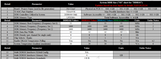

  • hi  Keerthy J
             This is the DDR mapping.
    but when I disable  CONFIG_K3_INLINE_ECC ; The system can run
    wen I enable  CONFIG_K3_INLINE_ECC ,The uboot was stoped.
