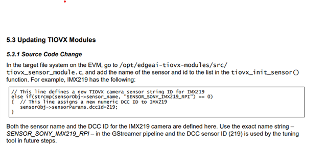

For AM625 ISP Tuning Guide i am refering this pdf which is provided by ti only:- /cfs-file/__key/communityserver-discussions-components-files/791/sprad86a-_2800_1_2900_.pdf
It mentioned that The ISP tuning procedure described in this report applies to all SoCs in the AM6xA vision processor family, including AM62A, AM68A, and AM69A. Examples using the AM62A Starter Kit EVM are provided in the report.
Model:- AM62X EVK with SDK Version :- 09.02.01.09
I can able to see the camera position here:-

Now problem is i am not able to find /opt/edgeai-tiovx-modules/src/ tiovx_sensor_module.c on EVK do we need to manually create this .c file or how to edit this file.
i have try to add tiovxisp but getting below errors:-
root@am62xx-evm:/opt/edgeai-gst-apps/scripts# vi /opt/edgeai-gst-plugins/ext/tiovx/gsttiovxisp.c
root@am62xx-evm:/opt/edgeai-gst-apps/scripts# export SOC=am62a
root@am62xx-evm:/opt/edgeai-gst-apps/scripts# ./install_tiovx_modules.sh
Cloning into 'edgeai-tiovx-modules'...
fatal: unable to access 'https://git.ti.com/cgit/edgeai/edgeai-tiovx-modules/': Could not resolve host: git.ti.com
root@am62xx-evm:/opt/edgeai-gst-apps/scripts# vi /opt/edgeai-tiovx-modules/src/tiovx_sensor_module.c
root@am62xx-evm:/opt/edgeai-gst-apps/scripts# ./install_gst_plugins.sh

ERROR: Clock skew detected. File /opt/edgeai-gst-plugins/build/../meson.build has a time stamp 1520595884.8494s in the future.
A full log can be found at /opt/edgeai-gst-plugins/build/meson-logs/meson-log.txt
root@am62xx-evm:/opt/edgeai-gst-apps/scripts# cd
root@am62xx-evm:~# gst-inspect-1.0 tiovxisp
No such element or plugin 'tiovxisp'
root@am62xx-evm:~# cd /opt/edgeai-gst-apps/scripts
root@am62xx-evm:/opt/edgeai-gst-apps/scripts# gst-inspect-1.0 tiovxisp
how to resolve them ?
