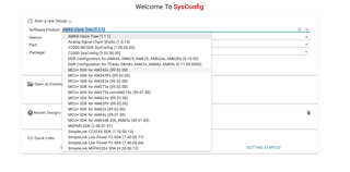

Is there a way to generate the clock tree for TDA4VH using sysconfig? Using the web tool I see an option to do this for AM62X, but none of the TDA4 platforms. If not, whats the recommended way to generate and view clock settings for the various clocks and PLLs?
  • Hi Jeremy,
    This feature is not supported for TDA4VH or other TDA platforms. Alternatively, you can refer TDA4VH TRM chapter 5.4 for details.
