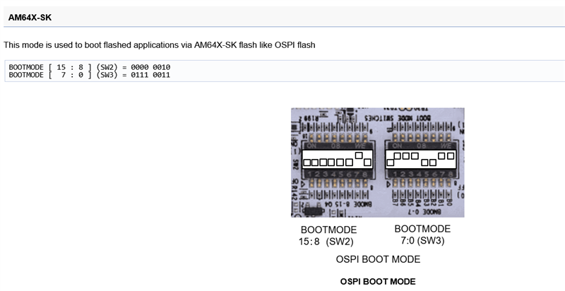

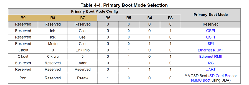

Hello!
I've been following the steps in the EVM Setup Guide, and I have successfully used uart_uniflash to flash the SOC initialization binary to the board. The next step is to set the DIP switches to OSPI boot mode, but I can't figure out how to do that. My board isn't like the one in the guide, as I have the HSFS version, and so none of the dip switch configurations have been the same. I can't find any examples of the correct configuration however.  How do I proceed with the guide?
