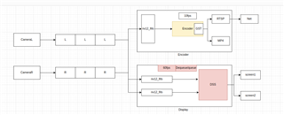

My English is not very good and my expression may not be accurate. I hope you can understand. Sorry.
Hardware: TDA4VM
SDK: 0806
My current needs are as follows:
The encoding thread runs at 10fps
The display thread  runs at 60fps
The results of my test are as follows:
The encoding thread runs at 10fps, but the display thread cannot run at 60fps. The reasons I found are as follows:
When the encoding thread is opened, the time consumption of the display thread will increase.

The parts I tested that influence each other are as follows:
If I comment the following code in the coding thread
appCodecEnqAppSrc(obj->appsrc_push_id);
Then the following code in the display thread takes 6~8ms, and the display thread can run to 60fps
vxGraphParameterDequeueDoneRef(obj->graph_left, obj->displayObj_csi_tx_vc0_left.output_graph_parameter_index, (vx_reference*)&output_image, 1, &num_refs);
If I enable this part of the code
Then the following code in the display thread will take 10~14ms to compile, then the display thread will not run 60fps
My questions:
Why does this operation of the encoding thread
This will increase the time consumption of this function
