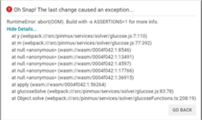

Q1: Could you please let me know if there is a solution to the following error?
By adding GPIO settings in sysconfig when configuring pin settings in CCS, we ware able to add all pins for MCU_GPIO0 in the MCU domain and GPIO0 in the main domain among the three modules.
However, if we try to add GPIO1 settings in this state, a RuntimeError will occur in sysconfig as shown above.
This seems to occur when a large number of pin settings are made at the same time on GPIO0 and GPIO1 of the main domain.
The same error occurs even if we write directly to the .syscfg file, so when checking the operation, we solved it by changing the GPIO module to be set.
(Movement could be confirmed in each of the three modules.)

  • Hello O.H,
    Thanks for reaching out to Texas Instruments E2E support forum.
    Can you please share the example.syscfg file which is creating the problem?

  • Hello Tushar,
    Thank you for your supports.
    Please refer to this file.

  • Hello O.H.
    Thanks for your patience.
    I have checked the above Sysconfig file and able to reproduce the issue. This is a known issue and need changes from sysconfig tool also.
    I have filed an internal Jira ticket for the same, but this is not planned to be fixed in next release of MCU+SDK.
    Tushar

  • Hello Tushar,
    Thank you for your reply.
    I understood. It would be helpful if you could let me know the release schedule, even if it's just a plan.
    O.H
