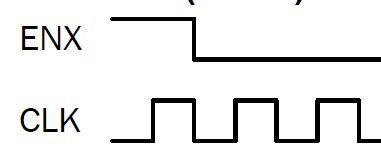

I'm using a CH0 of the MCSPI device in master mode. My SPI slave device requires a half CLK cycle before chip select (ENX in image) assertion.
How can I make the MCSPI to generate the this extra half clock cycle?

  • Hi Vaibhav,
    I've already tried to communicate and didn't work.
    The problem is that my device requires a half CLK cycle before asserting the chip select signal as in the following image:
    The MCSPI device generates CLK pulses after asserting the chip select signal and keeps it deasserted while the chip select is deasserted.
    I'm using the MCU PLUS SDK.
    Thank you,
    Enrique

  • Hi Enrique,
    Thanks for your patience.
    I was looking into this for quite a while and realized the following.
    I got to know that in the SysConfig GUI under MCSPI peripheral tab, when you add a MCSPI peripheral you will see an option as highlighted in the attached screenshot below.
    Under show advanced config: You can go ahead and select the initial delay in terms of bus clock cycles.
    Please go ahead and experiment with this option and let me know if this helps you get started with development on MCSPI.
    Looking forward to your response.
    Vaibhav
