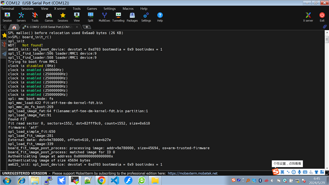

However, when r5 SPL loads the kernel image and ramfs, it takes a long time to wait, as shown in the following video:
The following are the sizes of kernel images, ramfs images, and atf-tee-dm-kernel-fdt.bin images:

    Could you please share the UART logs with timestamps to get a better idea about the time taken to load the Falcon image.
    Please also share the R5 U-Boot defconfig file you are using.
    Prashant
  • hello,
    UART logs with timestamps are asfollows:
    =~=~=~=~=~=~=~=~=~=~=~= MobaXterm log 2024.05.29 01:20:48 =~=~=~=~=~=~=~=~=~=~=~=
    [2024-05-29 01:20:48]  U-Boot SPL 2021.01-00003-gf4dc0be4cb-dirty (May 29 2024 - 01:16:15 +0000)
    [2024-05-29 01:20:48]  SYSFW ABI: 3.1 (firmware rev 0x0008 '8.6.4--v08.06.04 (Chill Capybar')

    [2024-05-29 01:20:48]  spl_load_fit_image:281
    [2024-05-29 01:20:48]  External data: dst=80080000, offset=97ca8, size=121e067
    [2024-05-29 01:20:55]  spl_load_fit_image:339

    [2024-05-29 01:20:55]  External data: dst=81600000, offset=12b5d10, size=8bb56b
    [2024-05-29 01:20:58]  spl_load_fit_image:339
    [2024-05-29 01:20:58]  am625_init: spl_boot_device: devstat = 0xd703 bootmedia = 0x9 bootindex = 1
    [2024-05-29 01:20:59]  am625_init: spl_boot_device: devstat = 0xd703 bootmedia = 0x9 bootindex = 1
    [2024-05-29 01:20:59]  init_env from device 9 not supported!
    [2024-05-29 01:20:59]  jump_to_image_no_args:245
    [2024-05-29 01:20:59]  jump_to_image_no_args:248
    [2024-05-29 01:20:59]  Loading phdr 0 to 0x41010040 (4784 bytes)
    [2024-05-29 01:20:59]  Loading phdr 1 to 0x410112f0 (432 bytes)
    [2024-05-29 01:20:59]  Loading phdr 2 to 0x410114a0 (408 bytes)
    [2024-05-29 01:20:59]  Loading phdr 3 to 0x41011a40 (4424 bytes)
    [2024-05-29 01:20:59]  Loading phdr 4 to 0x9db00000 (4096 bytes)
    [2024-05-29 01:20:59]  Loading phdr 5 to 0x9dc00000 (0 bytes)
    [2024-05-29 01:20:59]  Loading phdr 6 to 0x9dc00680 (0 bytes)
    [2024-05-29 01:20:59]  Loading phdr 7 to 0x9dc18f00 (88304 bytes)
    [2024-05-29 01:20:59]  Loading phdr 8 to 0x9dc2e7f0 (0 bytes)
    [2024-05-29 01:20:59]  Loading phdr 9 to 0x9dc3e7f0 (27672 bytes)
    [2024-05-29 01:20:59]  Loading phdr 10 to 0x9dc45480 (5376 bytes)
    [2024-05-29 01:20:59]  Loading phdr 11 to 0x9dc46980 (1922 bytes)
    [2024-05-29 01:20:59]  Loading phdr 12 to 0x9e6f6c00 (0 bytes)
    [2024-05-29 01:20:59]  Loading phdr 13 to 0x9e6f8000 (0 bytes)
    [2024-05-29 01:20:59]  jump_to_image_no_args: jumping to address 9dc2d320

    After opening the debugging of mmc.c, the output log after power on is as follows:
    =~=~=~=~=~=~=~=~=~=~=~= MobaXterm log 2024.05.29 06:45:10 =~=~=~=~=~=~=~=~=~=~=~=
    [2024-05-29 06:45:10]  U-Boot SPL 2021.01-00003-gf4dc0be4cb-dirty (May 29 2024 - 06:35:05 +0000)
    [2024-05-29 06:45:10]  SYSFW ABI: 3.1 (firmware rev 0x0008 '8.6.4--v08.06.04 (Chill Capybar')
    [2024-05-29 06:45:10]  TLB table from bfffc000 to c0000000
    [2024-05-29 06:45:10]  SPL initial stack usage: 13424 bytes
    [2024-05-29 06:45:10]  SPL malloc() before relocation used 0x6aa0 bytes (26 KB)
    [2024-05-29 06:45:10]  >>SPL: board_init_r()
    [2024-05-29 06:45:10]  spl_init
    [2024-05-29 06:45:10]  WDT:   Not found!
    [2024-05-29 06:45:10]  am625_init: spl_boot_device: devstat = 0xd703 bootmedia = 0x9 bootindex = 1
    [2024-05-29 06:45:10]  spl_ll_find_loader:506 loader:MMC1 device:9
    [2024-05-29 06:45:10]  spl_ll_find_loader:508 loader:MMC1 device:9
    [2024-05-29 06:45:10]  Trying to boot from MMC1
    [2024-05-29 06:45:10]  clock is disabled (0Hz)
    [2024-05-29 06:45:10]  clock is enabled (400000Hz)
    [2024-05-29 06:45:10]  clock is enabled (25000000Hz)
    [2024-05-29 06:45:10]  spl: mmc boot mode: fs
    [2024-05-29 06:45:10]  spl_mmc_load:422 fit:atf-tee-dm-kernel-fdt.bin
    [2024-05-29 06:45:10]  spl_mmc_do_fs_boot:269
    [2024-05-29 06:45:10]  spl_load_image_fat:64 filename:atf-tee-dm-kernel-fdt.bin partition:1
    [2024-05-29 06:45:10]  spl_load_image_fat:91
    [2024-05-29 06:45:10]  Found FIT

    The relevant information of mmc is as follows:
    LI
    It seems like the clock is only 25MHz which may be the root cause.
    Can you please try the suggested patch in the below response to switch the clock source for having 200MHz
    https://e2e.ti.com/support/processors-group/processors/f/processors-forum/1316879/sk-am62a-lp-load-speed-problem-with-emmc-in-falcon-boot-mode/5010012#5010012
    Prashant
    I made the following modifications:
    root@ubuntu-1804:/home/liweiyu/am62x/debug/ti-processor-sdk-linux-rt-am62xx-evm-08.06.00.42/board-support/u-boot-2021.01+gitAUTOINC+2ee8efd654-g2ee8efd654# git diff arch/arm/dts/k3-am62-main.dtsi

    After referring to the link you provided for modification, there was an error during startup, as shown below:
    U-Boot SPL 2021.01-00003-gf4dc0be4cb-dirty (May 29 2024 - 08:22:33 +0000)
    >>SPL: board_init_r()
    spl_init
    WDT:   Not found!
    clock is enabled (200000000Hz)
    unable to select a mode : -70
    spl: mmc init failed with error: -524
    SPL: failed to boot from all boot devices
    ### ERROR ### Please RESET the board ###

    So, I have reproduced the issue when booting from the eMMC backup bootmode:
    [11:55:04] U-Boot SPL 2021.01-dirty (May 30 2024 - 11:54:13 +0530)
    [11:55:04] SYSFW ABI: 3.1 (firmware rev 0x0008 '8.6.4--v08.06.04 (Chill Capybar')
    [11:55:04] SPL initial stack usage: 13424 bytes
    [11:55:04] am625_init: spl_boot_device: devstat = 0x1403 bootmedia = 0x9 bootindex = 1
    [11:55:04] Trying to boot from MMC1
    [11:55:04] clock is disabled (0Hz)
    [11:55:04] clock is enabled (400000Hz)
    [11:55:04] clock is enabled (25000000Hz)
    [11:55:04] spl: mmc boot mode: fs
    [11:55:04] fit read sector 0, sectors=1336, dst=82fffac0, count=1336, size=0x538
    [11:55:04] firmware: 'atf'
    [11:55:04] External data: dst=9e780000, offset=538, size=b2e9
    [11:55:04] Authentication passed
    [11:55:04] Image OS is ARM Trusted Firmware
    [11:55:04] loadables: 'tee'
    [11:55:04] External data: dst=9e800000, offset=b824, size=66ee1
    [11:55:04] Loadable is Trusted Execution Environment
    [11:55:04] loadables: 'dm'
    [11:55:04] External data: dst=89000000, offset=72708, size=25a39
    [11:55:04] Loadable is Unknown OS
    [11:55:04] loadables: 'kernel'
    [11:55:11] External data: dst=80080000, offset=98144, size=1242a00
    But I did not see the issue when using eMMC primary bootmode. Could you please confirm if you also see the same?
    Prashant
    Our hardware currently only supports eMMC backup bootmode mode and does not support eMMC primary bootmode.
    We also hope that TI can solve the problem of long kernel loading time during eMMC backup bootmode startup。
    LI
    In that case, let me work on this and get back to you.
    Prashant
    Is there any progress? Our client is quite anxious about this issue.
    Li
    I have been debugging and it seems like the eMMC tuning is failing for eMMC backup boot causing degradation in the R/W performance. I think I am close to finding the root cause and the fix as well.
    Please allow me a day or two to get back to you.
    Thanks for your patience.
    I tested and found that the first time the board was powered on, the speed of loading atf-tee-dm-kernel-fdt.bin was very slow. When the system started up to the shell terminal console, entering the reboot command to perform a hot start reset, the board loaded atf-tee-dm-kernel-fdt.bin very quickly
    I did observe this behaviour. The eMMC backup boot is quick if happens through warm reset but not through cold reset.
    I think I may have identified the possible cause of this issue. Apparently, in eMMC backup boot, the ROM only uses the BUS_WIDTH of 1 and so accordingly configures the eMMC controller and the eMMC card.
    With the leftover eMMC configurations from ROM, the U-Boot seems to have trouble configuring the eMMC in the highest mode possible. It tries configuring the eMMC in BUS_WIDTH of 8 but fails ultimately settling on BUS_WIDTH of 1 only resulting in the R/W speed degradation.
    Attaching the U-Boot debug logs for reference

    [18:05:38] CMD_SEND:12
    [18:05:38]              ARG                      0x00000000
    [18:05:38]              MMC_RSP_R1b              0x00000b00
    [18:05:38] CMD_SEND:16
    [18:05:38]              ARG                      0x00000200
    [18:05:38]              MMC_RSP_R1,5,6,7         0x00000900
    [18:05:38] CMD_SEND:18
    [18:05:38]              ARG                      0x00000846
    [18:05:38]              ARG                      0x0000084c
    [18:05:38]              ARG                      0x00000852
    [18:05:38]              ARG                      0x0000bd84
    [18:05:44]              MMC_RSP_R1,5,6,7         0x00000900
    [18:05:44] CMD_SEND:12
    [18:05:44]              ARG                      0x00000000
    [18:05:44]              MMC_RSP_R1b              0x00000b00
    [18:05:44] CMD_SEND:16
    [18:05:44]              ARG                      0x00000200
    [18:05:44] CMD_SEND:17
    [18:05:44]              ARG                      0x00014f96
    [18:05:44] External data: dst=80080000, offset=258, size=1242a00
    [18:05:44] Warning: Did not detect image signing certificate. Skipping authentication to prevent boot failure. This will fail on Security Enforcing(HS-SE) devices
    [18:05:45] Image OS is Linux
    [18:05:45] no string for index 1
    [18:05:45] Loading Environment from MMC... CMD_SEND:16
    [18:05:45]              ARG                      0x00000200
    [18:05:45]              MMC_RSP_R1,5,6,7         0x00000900
    [18:05:45] CMD_SEND:17
    [18:05:45]              ARG                      0x00000000
    [18:05:45] CMD_SEND:16
    [18:05:45] CMD_SEND:6
    [18:05:45]              ARG                      0x03b34900
    [18:05:45]              MMC_RSP_R1b              0x00000800
    [18:05:45] CMD_SEND:13
    [18:05:45]              ARG                      0x00010000
    [18:05:45] CURR STATE:4
    [18:05:45] CMD_SEND:18
    [18:05:45]              ARG                      0x00003400
    [18:05:45] CMD_SEND:12
    [18:05:45]              MMC_RSP_R1b              0x00000b00
    [18:05:45]              ARG                      0x03b34800
    [18:05:45] OK
    [18:05:45] am625_init: spl_boot_device: devstat = 0x1403 bootmedia = 0x9 bootindex = 1
    [18:05:45] init_env from device 9 not supported!

    We have identified the root cause of the issue and the fix as well.
    Apparently, the pinmuxing configuration for mmc0 was missing in the R5 DTB falling back to the pinmuxing done by ROM. Since, in eMMC backup boot, ROM uses only one data line, the other seven are left unconfigured resulting in the issue. Everything works fine in primary bootmode since ROM configures all the eight data lines.
    PFA the patch that should enable the mmc0 pinmuxing.
    diff --git a/arch/arm/dts/k3-am62x-sk-common-u-boot.dtsi b/arch/arm/dts/k3-am62x-sk-common-u-boot.dtsi
    index b57d9563d87..52637fc3de4 100644
    --- a/arch/arm/dts/k3-am62x-sk-common-u-boot.dtsi
    +++ b/arch/arm/dts/k3-am62x-sk-common-u-boot.dtsi
    @@ -112,6 +112,10 @@
     	u-boot,dm-spl;
    +&main_mmc0_pins_default {
    +    u-boot,dm-spl;
     &main_mmc1_pins_default {
     	u-boot,dm-spl;
    I have tested the patch successfully. Attaching the logs for reference
