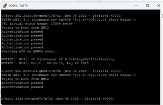

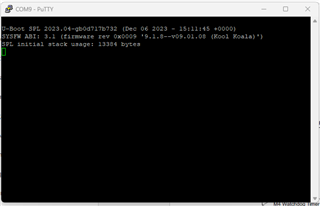

With our custom board:
With the development board:
I've noticed that the SD clock seems to stop after the characters (in the first image) are displayed in the terminal window on the custom board.  How far in the boot process should the SD card boot be able to proceed to.  I'm starting off with "tisdk-default-image-am62xx-lp-evm.wic.xz" and hope to disable some of the configuration to use it on our custom board.
  • Hi Jim,
    It looks like your custom board uses different DDR device from the EVM, that is why the boot stops very early.
    You would have to use the SysConfig tool to generate the DDR config data for the DDR device used on your board, integrate the data to U-Boot and rebuild U-Boot.

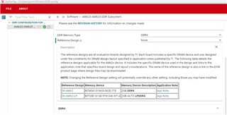

  • We have the MT40A2G8AG-062E AUT:F memory chip.   The memory type selected in you DDR Configuration tool should be DDR4 (I believe)?  Will selecting SK_AM62 as the Reference Design be useful?  Also, our chip is the AM620-Q1.  Will this tool work for this?

  • Jim, the device you have MT40A2G8AG-062E  is a x8 memory, whereas the EVM has a x16 memory, so some configuration changes are needed in the tool.  Please check the README link in the tool, it will have some guidance.
    I assume you have two x8 devices?  You basically need to change:
    Data Bus Width (per device) = 8
    and then re-build uboot with the new configuration file.
    Possibly some other tweaks would be needed, but i would need more info or schematic of the board.

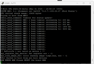

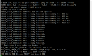

  • We made the changes in the ddr and I replaced the U-Boot k3-am62x-ddr-lp4-50-800-800.dtsi with our newly generated file (renaming ours to "k3-am62x-ddr-lp4-50-800-800.dtsi "), rebuilt U-Boot (using the SDK Top Level Makefile) and moved tiboot3.bin, tispl.bin and u-boot.img to the SD Card with the "tisdk-default-image-am62xx-lp-evm.wic.xz" image.    We seem to lose our SD Card clock:
  • Hi Jim,
    Could you please apply the following patch and share the boot logs?
