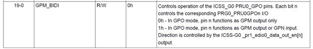

  • Hi Ryan,
    want to change the direction of the PRU GPI/GPO signals dynamically during run time
    You can do that by setting the [19-0]GPM_BIDI bit field of the CTRLMMR_ICSSG[2:0]_CTRL[2:0] register, this will make the pin bidirectional and you can toggle between input and output by programming the EDIO DATA_OUT_EN bit field.
    You can read about it in the TRM section 6.4.2.2 PRU_ICSSG Fast GPIO pins and 5.1.1.5.41 CTRLMMR_ICSSG0_CTRL0 Register

  • Hi Nitika,
    Thanks for your response, I've reviewed the two sections in the Technical Reference Manual but I think I am still missing something as I do not see any input bits set in R31 still.
    I set bits 0-19 in the CTRLMMR_ICSSG0_CTRL0 register to 1, to enable them to function as output or input per the manual description below
    ;Set bits 0-19 of CTRLMMR_ICSSG0_CTRL0 to 1 to enable PRU fast GPIO as output and input
    ldi32 TEMP_REG, 0xFFFFF
    ldi32 CTRL_REG, 0x43004100
    sbbo &TEMP_REG, CTRL_REG, 0, 4
    Then to control the direction I set bits 0-9 in the IEP_DIGIO_DATA_OUT_EN_REG referenced from CTRLMMR_ICSSG0_CTRL0 so that they would be enabled for inputs
    ;Set bits in IEP_DIGIO_DATA_OUT_EN_REG, GPIOs 0-9 to inputs, 10-19 as outputs
    ldi32 TEMP_REG, 0x3FF
    ldi32 EN_REG, 0x3002E314
    sbbo &TEMP_REG, EN_REG, 0, 4
    Then I connected a loopback cable such that the PRU Fast GPIOs 10-19 are connected to 0-9 and wrote R30 bits 10-19 as 1.  However, when checking the contents of the R31 register I do not see bits 0-9 set.

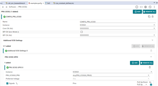

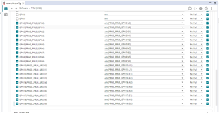

  • Hi Nitika,
    Thanks for your investigation. To help eliminate any potential differences in our projects is there anything I should explicitly set or not set with regards to the PRU ICSS GPIO settings in SysConfig? Section 6.4.2.2 seems to indicate that the pins should be configured for GPO when using the bi-directional functionality.
    Ryan
  • Hi Ryan,
    The Sysconfig settings looks fine.

        ldi     WRITE_REG, 0x0100
        sbco    &WRITE_REG, ICSS_PRU_CTRL_CONST, 0x28, 2
    ; Cofigure bidirectional mode on PRU GPIOs
        ;Unlock CTRLMMR kick protection registers
        ;ldi32   TEMP_REG, 0x68EF3490
        ;ldi32   CTRL_REG, 0x43001008
        ;sbbo    &TEMP_REG, CTRL_REG, 0, 4
        ;ldi32   TEMP_REG, 0xD172BC5A
        ;ldi32   CTRL_REG, 0x4300100C
        ;ldi32   TEMP_REG, 0xFFFFF
        ;ldi32   CTRL_REG, 0x43004100
        ;ldi32   TEMP_REG, 0x3FF
        ;ldi32   EN_REG,   0x3002E314
        ;sbbo    &TEMP_REG, EN_REG, 0, 4

  • Hi Ryan,
    You might be missing input enable configuration for pad, which can be done from Sysconfig itself
    After this you should be able to read input status from R31 register of PRU.
    I am able to evaluate this on my setup, please let us know if this issue persists.
    Thanks & Regards,
    Manoj.
  • Yes, that was the last missing piece. Just got back and was able to confirm reading input status on R31 now, also confirmed ability to switch direction during run time.
