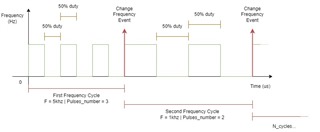

  • My specification for this specific output would be:

  • Hello Rafael,
    For your requirement, I wanted to suggest going with the ECAP module on M4F core, but unfortunately, this is also not supported on M4F core.
    So, we need to go with Timer + GPIO.  Already, there is time interrupt that can be generated from the system config as per your requirement and you  need to  split  an ISR routine in 3 states.
    State 0 → idel state which will drive the GPIO low and will monitor no of pulses input  and frequency request. Based on this input, your states will be changed .
    I am sharing generic code based on the above example you can modify according to your, use case.
    Actually this is one of the method to achieve your requirement .

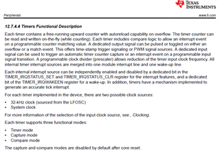

  • But what about the timers here? I saw this diagram and descriptions of features in the AM623 reference manual and found this information, however, without abstractions for them. Is there any example or something similar related to this?

  • Hi Rafael,
    Yes, it is possible with Timer PWM as well. But, in our MCU+SDK, we use it for timer purposes.
    But, for your requirement generate the PWM signal frequency with a 50% duty cycle is possible and remaining functionality, like controlling no of pulses and frequency changes and driving pwm low or high based on your requirement should be controlled by you.
    I can try to provide steps for how to do itSo, that you can try at your side and let us know the status .

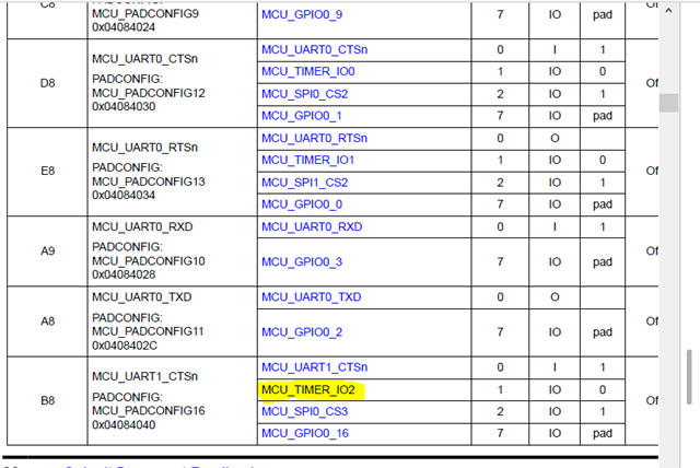

  • Hello Rafael,
    I have tried the below steps to generate PWM  from the Timer Module.
    1. Each timer has a single pin and it can be used in PWM or CAP mode.
    Currently, in MCU+SDK, it does not support this pin configuration.
    So, you need to configure based on timer and pins from the datasheet.
    I have used MCU Timer 2 and B8 pin is available on AM64X EVM for testing purposes. So, I have used this pin.

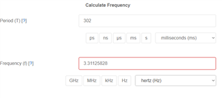

  • Can you please tell me what calculation was set to adjust the frequency to 5khz and the duty to 50%? I am adjusting the frequencies and getting a gap in what I want

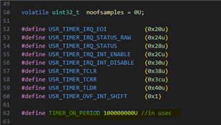

  • I'm trying to adapt the function to pass the frequency and duty cycle to the PWM signal, however, without success, due to the nature of the calculation. Do you have any ideas? And, also, there is a maximum frequency for the PWM signal, because I need to reach 200khz.
    im trying something like that

  • for the PTO, 50% duty cycle is fine, however, I also need to develop a PWM interface with the same peripherals. The need to change the duty cycle in a scale of 1% - 99% is there. In this case, for 200khz I used this, and works nice:
    #define TIMER_ON_PERIOD (2500 * 1000)

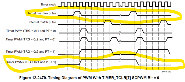

  • Hello Rafael,
    Please look at the image below.
    The PWM is generated based on either overflow or overflow and match type.
    Currently, I have enabled with overflow.
    So, frequency and duty values are purely based on overflow value.
    For example, if you need a 10% duty cycle with 1 KHz frequency.
    TON = 10% * 1K and TOFF = 90% * 1K. So, in this time period you need to change  for every time in the Timer ISR routine .
    If you need to 200KHz with different duties from 1% to 99%.
    We are feeding a 25MHz clock to the time without any scaling.
    For 1% duty, TON = 1% of 200KHZ and the remaining TOFF = 99% of 200KHz time should be loaded.
    So, for every time you need to load the TON and TOFF periods in the ISR routine, this way you can achieve different duties and frequencies.
    There is a TIMER_MAR register to see if this register can be used for duty and the over overflow timer can be used for frequency and try with this method also.

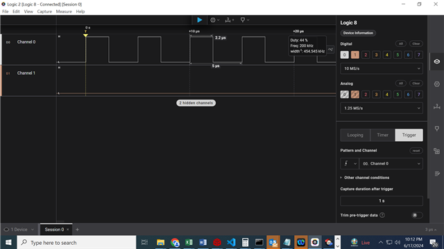

  • If i just start the code by code composer, it provides me a 50% duty 1khz. But, if i build step by step, the duty is working but the frequency is 3khz. I just change my timer for MCU_TIMER3 and TIMER_IO3. Any idea where is the problem?
  • With the values 45 for duty and 5000 for period, i got this (Just debugging step by step):
    Without being step by step, I only achieve this in 100% of situations:
  • Hello Rafael,
    Please look at the image below and I got frequency 200KHz and duty is 44%.
    I am not sure why you are having strange behavior.
    Did you integrate my changes into your application ?
    How are you loading an application from CCS or Linux ?
    Can you do POR or warmest the devices and load the application and still see if you have an issue ?
    How did you feed duty and frequency values in application ? You are changing them frequently  in the code or only calling for one time.
    Anil.

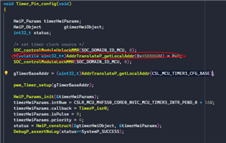

  • Hello! The only modification i made is the timer instance:
    The code is the same that you give to me.
    Im loading my aplication by CCS.
  • Still my code run properly only step by step debug on CCS.
  • Hello Rafael,
    The first problem is that your application is not properly selecting the correct clock for Timer 3.
    For the Timer 3 clock selection we need to use the address below.
    So, you need to change the red-colored with to the 0x450806C address.

    Hello Rafel,
    If the timer clock selection is other than 25MHz, then the PWM frequency will be different according to the 5000 Counter value for 200KHz.
    So, please confirm did you change the clock selection address in both your setups or not ?
    Even if you change the clock selection address and does not come proper PWM signal frequency, then check the TMAR and TLDR registers are properly loaded with your input or not.
    I have verified that I am able to get 200KHz from 1% to 99% duty and only issue with the TCLR registers need some more time to update it s values .
    Anil.
