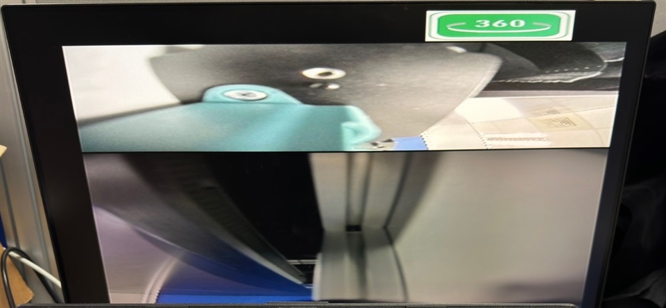

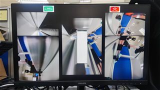

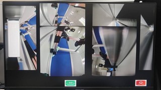

  • We use RTOS driver.
    We run our application and use display node to display .
    This image is normal display.
    normal
    This image is wrong resolution display

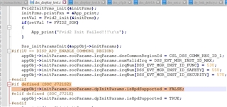

  • Hi Nikhil Dasan ,
    How to support hot plug detect on SDK 8.4 for j721s2??
    Are you using the EVM? If yes, then HPD is not supported on the EVM.

    When using our ECU to connect the display screen, an abnormal displa will occur when turning on the computer (such as the image provided by Joe, and my another image the display is shifted)
    During this issue, may I know what is the resolution shown on the Display / Monitor from the monitors properties/menu?
    Nikhil
  • Hi Nikhil,
    Can we use additional GPIO to polling HPD status and to init display driver?
    During this issue, may I know what is the resolution shown on the Display / Monitor from the monitors properties/menu? 640x1079 or 640x1080 by different display Monitor have to show.

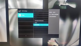

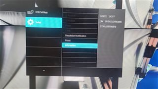

  • if using DP to DP cable : 640x1079, the resolution is incorrect and the display is abnormal.
    abnormal display:
    abnormal resolution:
    if using DP to HDMI cable :1920x1080, the resolution is correct, but the display is abnormal.
    abnormal display:
    normal display:
    normal resolution:

    We tried to add print log in Dss_dctrlDrvDpStartVideo.
    When the abnormal display was happen  ,the videoMode.width=1920、videoMode.height=1080、videoMode.pclk=148500,It means that the resolution of DP_TX output is normal, but the DP_RX(monitor) interpretation is wrong.
    I'm guessing there is something wrong with the display during the training process,Maybe the timing of the training on the DP_TX side or the training pattern  are incorrect, causing some problems with the clock recovery on the DP_RX(monitor) side.

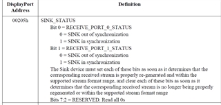

    What API or functions can we use to get the DPCD register value in the DP_RX?
    We want to  get value in the DP_RX DPCD register Address: 00205h(SINK_STATUS) through the J721s2 AUX CH.
    We have the API DP_ReadDpcd() in the pdk driver in the path pdk/packages/ti/drv/dss/src/csl/dp/src/dp_if.c
    Please refer it's usage in the driver to use the same.
