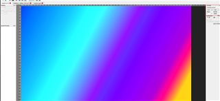

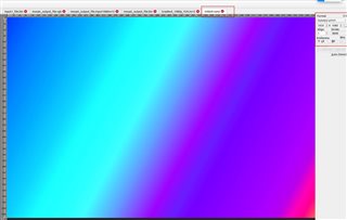

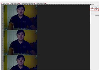

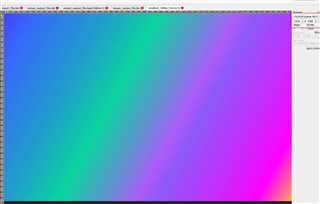

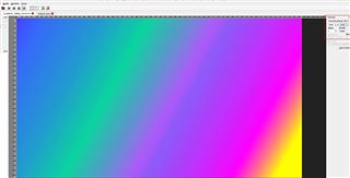

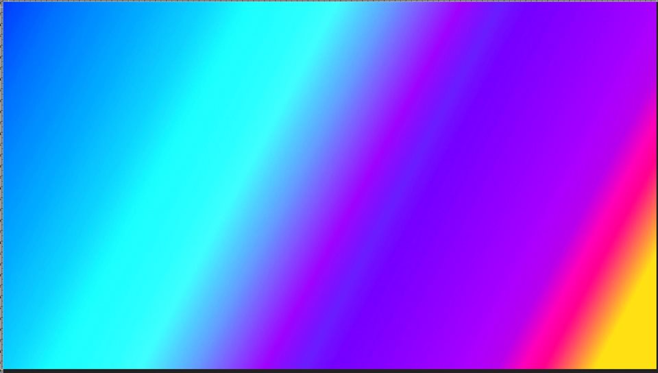

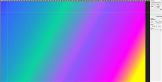

    I have made the following modifications:
    vision_apps/apps/basic_demos/app_linux_arm_opengl_mosaic:
    --- app_linux_arm_opengl_mosaic/main_linux_arm.c (版本 196)
    +++ app_linux_arm_opengl_mosaic/main_linux_arm.c (工作副本)
    @@ -348,7 +348,7 @@
    if(status == VX_SUCCESS)
    - output = vxCreateImage(context, outputWidth, outputHeight, VX_DF_IMAGE_RGBX);
    + output = vxCreateImage(context, outputWidth, outputHeight, VX_DF_IMAGE_UYVY);
    status = vxGetStatus((vx_reference) output);
    Index: vision_apps/kernels/sample/a72/vx_opengl_mosaic_target.c
    --- vision_apps/kernels/sample/a72/vx_opengl_mosaic_target.c
    +++ vision_apps/kernels/sample/a72/vx_opengl_mosaic_target.c
    @@ -154,7 +154,7 @@
    if (VX_DF_IMAGE_RGBX != output_desc->format)
    - status = VX_FAILURE;
    + // status = VX_FAILURE;
    @@ -263,7 +263,7 @@
    texProp[0].height = intermediate_dim.dim_y;
    texProp[0].pitch[0] = intermediate_dim.stride_y;
    texProp[0].pitch[1] = intermediate_dim.stride_y;
    - texProp[0].dataFormat = APP_EGL_DF_RGB;
    + texProp[0].dataFormat = APP_EGL_DF_UYVY;//APP_EGL_DF_RGB;
    #endif
    for (i = 0; i < MAX_TILES; i++)
    @@ -292,7 +292,7 @@
    renderTexProp.height = output_desc->imagepatch_addr[0].dim_y;
    renderTexProp.pitch[0] = output_desc->imagepatch_addr[0].stride_y;
    renderTexProp.pitch[1] = output_desc->imagepatch_addr[0].stride_y;
    - renderTexProp.dataFormat = APP_EGL_DF_RGBX;
    +renderTexProp.dataFormat = APP_EGL_DF_UYVY;//APP_EGL_DF_RGBX;
    renderTexProp.dmaBufFd[0] = output_desc->mem_ptr[0].dma_buf_fd;
    renderTexProp.dmaBufFdOffset[0] = output_desc->mem_ptr[0].dma_buf_fd_offset;
    @@ -446,7 +446,7 @@
    if (VX_SUCCESS == status)
    Index: vision_apps/kernels/sample/host/vx_opengl_mosaic_host.c
    --- vision_apps/kernels/sample/host/vx_opengl_mosaic_host.c
    +++ vision_apps/kernels/sample/host/vx_opengl_mosaic_host.c
    @@ -160,7 +160,11 @@
    - if (VX_DF_IMAGE_RGBX != output_fmt)
    + if ((VX_DF_IMAGE_RGBX == output_fmt)||(VX_DF_IMAGE_UYVY == output_fmt))
    + else
    status = VX_ERROR_INVALID_PARAMETERS;
    VX_PRINT(VX_ZONE_ERROR, "'output' should be an image of type:\n VX_DF_IMAGE_RGBX \n");
    The following is the error log of running/vx-app-arm-opengl_msaic.out after my modifications, Run normally before modification.

  • gj,
    Is there any reason why the current egl Mosaic node can only output RGBX and restrict output in other formats?
    Before SDK 8.x, it was only capable of outputting RGBX. Now, in SDK 9.x, we are able to output in YUV formats as well.
    Can you share your complete changes as a patch file?
    I see that the GPU experienced a hardware recovery. This is not expected given that there should not be an error in the driver. I assume you don't see this usually when running the application.
    Erick

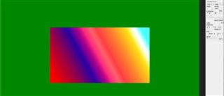

  • HI.Erick
        Why does the output of this demo display a significantly different UYVY image (output. nv12) from the input image (yuv image/Gradient_1080p_YUV. nv12)?
    gj
  • gj,
    The demo renders the texture in the center of the screen, so the green area around the texture is on purpose.
    I will need to check, however, the rendered texture in the center. It does look quite different than the rendered texture. It should be simple to investigate if I switch the color to something easier, like all green texture.
    Erick

     input image:
      input_file.tar.gz
    Before adding a patch, generate an image using vx_ app arm opengl mosaic.out:
    output1.tar.gz
    After adding or not patching, generate images for vx-app-arm_opengl_mosaic.out:
    output2.tar.gz
    Yes. I'm running on J722s EVM on the downloaded SDK 9.2 (no changes)
    Your input image is of size 4147200 Bytes (which looks like a 1920 x 1080 UYVY image) (i.e. 1920 x 1080 x 2 = 4147200)
    Could you please confirm the resolution of your input image? If yes, then can you try giving a NV12 as input?
    Nikhil

    The input and output images of this program are as follows:
    The input image is:
    input_nv12_image.tar.gz
    The outpu image is:
    output_yuv422.tar.gz
    this is input image:
    this is outpu image:
  • Hi gj,
    Not sure which is correct, but UYVY format looks more closure to the input, is this what you are expecting?
    Brijesh
  • HI,
        This is the output after I modified the EGL script. He is closer to input. I think the format is correct.
        This is a GPU output saved image with minimal color difference, which can be improved in the future. Because it is currently unable to display the output of CSIXT's GPU. How to use CSITX to display GPU output more urgently?
    Tip: The UYVY output by this app does not use Egl Mosaic nodes, while my app actually uses Egl Mosaic nodes.
    I believe you understand my requirement
    gj

  • Hi Erick
    There are still some differences after adding:
    input :
    output:
    Is this normal? Can you give it a try?
    gj

    Hi gang:
    Below patch we has tested at EVM board. it can meet GPU transfer color space request.
    Best Regards!
    Han Tao
    https://e2e.ti.com/cfs-file/__key/communityserver-discussions-components-files/791/correct_5F00_output.patch
