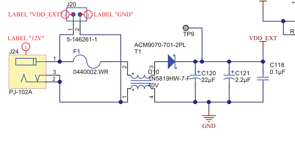

Our many new UB964 are not working with 4-camera connections after sometime of usage and we suspect reverse current flowing back to the power supply from the Deserializer UB964.
Can you please help us to know, how we can measure  it

    I'm not sure I completely understand your theory here. Can you please give more specifics about your setup and what led you to the theory about reverse current?
    Are you saying that there is electrical damage occurring to your 964 IC? Or something else in the system is getting damaged?
    What kind of test are you doing on this system when the damage occurs? Hot plugging cameras? Hot unplugging cameras? Other?
    Casey

  • Vyom,
    I still don't understand what you mean about reverse current. This board doesn't have the capability to back feed the 12V power supply. In fact there is a Schottky diode on the input rail to prevent backfeed to the power supply:
    Have you tried plugging the kit into a different power supply? Looks like the one you are using may be broken.
    How are you concluding that the deserializer is overheating? Do you have a thermal image of the board to share? I think more likely may be that there is something shorted in the PoC network connections or one of the PoC LDOs is damaged. Have you checked to see if you are getting the expected output voltages from VFEED_LDO1 and VFEED_LDO2?

    We have vehicle setup with 4-camera's , we were using DES UB964 board 1 and it stopped sending camera feed to EVM. Then connected another new DES UB964 and the same setup was working. The non-working DES UB964 got heated very badly with no reason.
    Physical observation while touching with hands compared to the working DES, I am not aware about creating the thermal image of the board, please let me know how I can generate and share to you?
