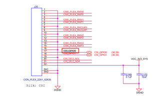

AM62A7: can't set TCA6424 CSI_GPIO0 to 1
Part Number: AM62A7
Other Parts Discussed in Thread: TCA6424
HI TI
device tree:
include <dt-bindings/gpio/gpio.h>
        clk_imx728_fixed: imx728-xclk {
                compatible = "fixed-clock";
                #clock-cells = <0>;
                clock-frequency = <24000000>;
&main_i2c2 {
        #address-cells = <1>;
        #size-cells = <0>;
        status = "okay";
        i2c-switch@71 {
                compatible = "nxp,pca9543";
                #size-cells = <0>;
                reg = <0x71>;
                /* CAM port */
                i2c@1 {
                        #size-cells = <0>;
                        reg = <1>;
                        imx728: camera@1d {
                                compatible = "sony,imx728";
                                reg = <0x1d>;
                                clocks = <&clk_imx728_fixed>;
                                clock-names = "xclk";
                                reset-gpios = <&exp1 15 GPIO_ACTIVE_HIGH>; //CSI_GPIO0
                                port {
                                        csi2_cam0: endpoint {
                                                remote-endpoint = <&csi2rx0_in_sensor>;
                                                link-frequencies = /bits/ 64 <456000000>;
                                                clock-lanes = <0>;
                                                data-lanes = <1 2>;
//driver code
static int imx728_power_on(struct device *dev)
        struct v4l2_subdev *sd = dev_get_drvdata(dev);
        struct imx728 *imx728 = to_imx728(sd);
        int ret;
        ret = regulator_bulk_enable(IMX728_NUM_SUPPLIES,
                                    imx728->supplies);
        if (ret) {
                dev_err(dev, "%s: failed to enable regulators\n",
                        __func__);
                return ret;
        ret = clk_prepare_enable(imx728->xclk);
        if (ret) {
                dev_err(dev, "%s: failed to enable clock\n",
                        __func__);
                goto reg_off;
        gpiod_set_value_cansleep(imx728->reset_gpio, 1);  // set csi_gpio0 high
        usleep_range(IMX728_XCLR_MIN_DELAY_US,
                     IMX728_XCLR_MIN_DELAY_US + IMX728_XCLR_DELAY_RANGE_US);
        return 0;
reg_off:
        regulator_bulk_disable(IMX728_NUM_SUPPLIES, imx728->supplies);
        return ret;

  • Dear TI,
         When I set TCA6424 CSI_GPIO0 to 1 in my camera driver, But it's still low when I measure it with a multimeter
  • Hello Daohong,
    The CSI_GPIO0 pin is pin #14 on I/O expander @ 0x22.
    Please refer to https://git.ti.com/cgit/ti-linux-kernel/ti-linux-kernel/tree/arch/arm64/boot/dts/ti/k3-am62a7-sk.dts?h=ti-linux-6.1.y#n566, and git.ti.com/.../k3-am62x-sk-csi2-imx219.dtso
    You should use the following in your dts:
    reset-gpios = <&exp1 13 GPIO_ACTIVE_HIGH>;
    Jianzhong
  • Hi Jianzhong,
          But  CSI_GPIO0 is connect to TCA6424  P15
  • Hi Daohong,
    I can see your point. I don't understand about TCA6424 very well, but I know " <&exp1 13 GPIO_ACTIVE_HIGH>" works fine for other cameras.
    Jianzhong
