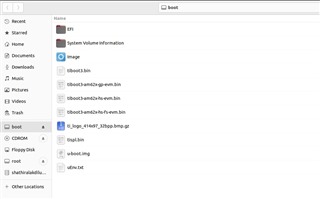

  • Did you prepare the SD card with Linux image? If you did, could you share a screenshot showing the SD card contents of the first partition?
  • Hi It's Tharusha here,
    This the the boot partition in the sd card.
  • This is the boot log in terminal

    I see you are using GP device. In that case, you would need to delete the existing tiboot3.bin in the SD card 1st partition and copy tiboot3-am62x-gp-evm.bin as tiboot3.bin.
    Please refer: https://dev.ti.com/tirex/explore/content/am62x_academy_9_02_00_00_v1/_build_am62x_academy_9_02_00_00_v1/source/linux/ch-eval/eval-flash-sdcard.html#boot-sdcard-on-am62x-gp
  • Thank You Prashant your coperation.
