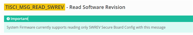

    2. I can't read back the SWREV value by TISCI_MSG_READ_SWREV for the first time for OTP_REV_ID_SBL & OTP_REV_ID_SYSFW.
       But it's ok for the OTP_REV_ID_SEC_BRDCFG. What's the difference design here?
    The Sysfw doesn't not yet support reading SWREV for SBL and Sysfw as documented here: https://software-dl.ti.com/tisci/esd/latest/2_tisci_msgs/security/otp_revision.html?highlight=tisci_msg_read_swrev
    Please note, the SWREV fields in the e-fuses for all the components comes already programmed with an initial value of 1 from TI.
