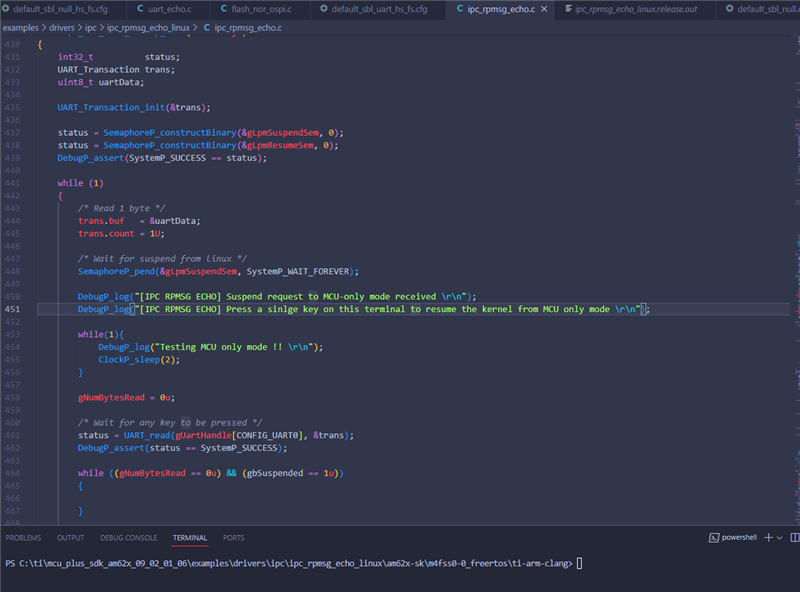

I am using ipc_rpmsg_echo_linux (M4 and R5F firmware - mcu_plus_sdk_am62x_09_02_01_06) and I followed the commands in this link, I executed the following:
echo enabled > /sys/bus/platform/devices/5000000.m4fss/power/wakeup
echo mem > /sys/power/state
The MCU_UART was printing:
[IPC RPMSG ECHO] Suspend request to MCU-only mode received
[IPC RPMSG ECHO] Press a sinlge key on this terminal to resume the kernel from MCU only mode
Then, I recompiled the M4 firmware after adding the code below (next to 'Press a sinlge key on this terminal to resume the kernel from MCU only mode' in the code)
while(1)
    DebugP_log("loop here... \r\n");
When I put the device in MCU Only, I saw the 'loop here...' messages in the MCU debug uart. But, after the linux prints the messages below, the M4 firmware also stops printing the 'loop here' messages.

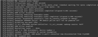

    So, once you ran the command:
    Then after this did the logs like the following came?
    [  175.651151] PM: suspend entry (deep)
    [  175.655444] Filesystems sync: 0.000 seconds
    [  175.667559] Freezing user space processes
    [  175.673951] Freezing user space processes completed (elapsed 0.002 seconds)
    [  175.681105] OOM killer disabled.
    [  175.684404] Freezing remaining freezable tasks
    [  175.690155] Freezing remaining freezable tasks completed (elapsed 0.001 seconds)
    [  175.697574] printk: Suspending console(s) (use no_console_suspend to debug)
    [  175.722262] omap8250 2800000.serial: PM domain pd:146 will not be powered off
    [  175.954174] Disabling non-boot CPUs ...
    [  175.956374] psci: CPU1 killed (polled 0 ms)
    [  175.959326] psci: CPU2 killed (polled 0 ms)
    [  175.962024] psci: CPU3 killed (polled 4 ms)

    I put it in line 452
    while(1)
    Also, I tried disabling ipc_rpmsg_echo_main in m4fss0-0_freertos and put the loop.

  • Hello John,
    Graceful shutdown
    "It tried to go sleep but it bail out"
    code: timeout waiting for rproc completion... can't stop rproc -16
    This usually tells you that Linux is trying to shut down the remote core, so it sends the remote core a shutdown message and then waits for an ACK. If the remote core does not send an ACK, Linux refuses to shut down the core and aborts the low power mode transition.
    For more information about graceful shutdown and how it works, refer to the AM62x academy:
    https://dev.ti.com/tirex/explore/node?node=A__AXsPVjrUN0EAU1ezb.8iuQ__AM62-ACADEMY__uiYMDcq__LATEST

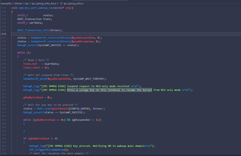

    I suspect what is happening is that your edits disabled the M4F code that handles the low power mode transition. In
    examples/drivers/ipc/ipc_rpmsg_echo_linux/ipc_rpmsg_echo.c :
    ipc_rp_mbox_callback
    lpm_mcu_uart_wakeup_task
    Let's back up
    Let's start with the "known good" example. Does it work as expected?
    What happens if you run the unmodified code?
    After the MCU_UART outputs this:
    Are you able to successfully wake up the processor by writing to the MCU_UART?
    Disabling low power mode in DM R5F is NOT what you want to do here
    Disabling low power mode (LPM) would disable MCU-only low power mode as well.
    The only time you would care about this is if you were writing your own custom code to run on the DM R5F core, alongside the device management (DM) task. That does not matter if you are only developing on the M4F core.

    void test_test(void *args)
        while(1)
            DebugP_log("Hello\n\r");
            ClockP_usleep(500);
    Then, put the device in MCU_ONLY
    Then, you will notice it stop printing log messages as well. This is something that we need help to understand how to put the said task running while in DS mode.
    John
  • Or the simplest way is to add while loop in m4 main.c

  • Hello John,
    Thank you for your patience.
    I have been able to replicate this issue. I have attached the screenshot below.
    I see that the text "Testing MCU only mode !!" gets logged/printed only once, but it should continue to print as it is put under a infinite while loop.
    I am also attaching the section where I introduced the code for the while loop.
