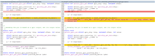

        I modified a little code in gpio-davinci.c to trace my test result as blow:
         From my tested log (as below), you can see the get value from davinci_gpio_get() always return a same value (0). That is my raised problem. Would you please help to check the reason and try to fix it? I guess you can reproduce this issue with your Am62ax-sk development board.

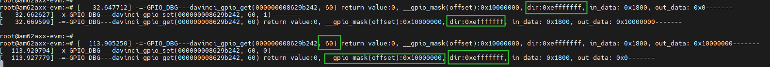

  • Hi David,
    Thanks for the explanation.
    It looks like when the get and set functions are called, the direction of the GPIO gets changed. So when set function is called, the GPIO direction is output. Then get function is called afterwards, the direction of the GPIO changes to input.
    Try to print the direction parameter if possible to check this.
    Anshu
  • Try to print the direction parameter if possible to check this.
    Hi Anshu,
        I continued to modify a little code as below, then I saw the output as below
    static int davinci_gpio_get(struct gpio_chip *chip, unsigned offset)
    struct davinci_gpio_controller *d = gpiochip_get_data(chip);
    struct davinci_gpio_regs __iomem *g;
    int bank = offset / 32;
    int ret = -1;
    g = d->regs[bank];
    ret = !!(__gpio_mask(offset) & readl_relaxed(&g->in_data));
    printk(KERN_ERR "-=-GPIO_DBG---davinci_gpio_get(%p, %d) return value:%d, __gpio_mask(offset):0x%x, dir:0x%x, in_data: 0x%x, out_data: 0x%x-------\n",
    chip, offset, ret, __gpio_mask(offset), readl_relaxed(&g->dir), readl_relaxed(&g->in_data), readl_relaxed(&g->out_data));
    return ret;
    It looks the dir is right (output) for gpio0_60.
    David
  • Hi Anshu,
        According to the log at the previous comment, I guess there is some bug in davinci_gpio_get(), so I tried to modify it as below, now from my test, it looks correct.  Would you please help me double confirm whether my modification is real CORRECT from your GPIO controller driver's owner (ie. the author of gpio-davinci.c)
    Thanks and best Regards,
    David

  • Hi David,
    The feedback I received from discussing internally was the following:
    "Even if the gpio is to be driven as input the pad configuration aka pin much should always be Pin_input in DTS. Basically bit18 of the pad configuration register should be set. That can help physically toggle the gpio as per need."
    Anshu
