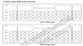

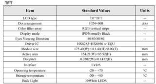

Hi
I am using SK AM62P-LP with PSDK 09.02.01.09
I want to use custom display which is a single link lvds
I changed the display accordingly
am62p5-sk.dts in u-boot
panel_lvds: panel-lvds {
		bootph-pre-ram;
		compatible = "simple-panel";

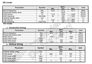

		panel-timings {
				bootph-pre-ram;
				clock-frequency = <51200>;
				hactive = <1920>;
				vactive = <600>;
				hback-porch = <160>;
				hfront-porch = <160>;
				vback-porch = <23>;
				vfront-porch = <12>;
				hsync-len = <0>;
				vsync-len = <0>;
				de-active = <1>;

But I am not getting the display after splash screen
root@am62pxx-evm:~# dmesg | grep tidss
[    6.242308] Modules linked in: panel_simple(+) display_connector(+) hci_uart btqca dwc3_am62 rtc_ti_k3 k3_j72xx_bandgap btbcm bluetooth ecdh_generic ecc rfkill ti_k3_r5_remoteproc tps6598x ili210x(+) virtio_rpmsg_bus crc_ccitt typec rpmsg_ns sii902x rti_wdt wave5 j721e_csi2rx videobuf2_dma_contig v4l2_mem2mem videobuf2_memops snd_soc_davinci_mcasp videobuf2_v4l2 v4l2_async videobuf2_common snd_soc_ti_udma snd_soc_tlv320aic3x_i2c snd_soc_tlv320aic3x sa2ul cdns_dphy_rx videodev snd_soc_ti_edma snd_soc_ti_sdma tidss drm_dma_helper drm_kms_helper mc syscopyarea sysfillrect sysimgblt fb_sys_fops fuse drm drm_panel_orientation_quirks ipv6
[    6.621572] [drm] Initialized tidss 1.0.0 20180215 for 30200000.dss on minor 0
[    6.650020] tidss 30200000.dss: [drm] Cannot find any crtc or sizes
[    6.659980] tidss 30200000.dss: [drm] Cannot find any crtc or sizes
[    6.673152] tidss 30200000.dss: [drm] Cannot find any crtc or sizes
root@am62pxx-evm:~# kmsprint
Connector 0 (40) LVDS-1 (connected)
  Encoder 0 (39) LVDS
Connector 1 (50) HDMI-A-1 (disconnected)
  Encoder 1 (49) NONE
what to do ?
    I am not sure about Uboot but for Linux are you sure you are programming the right clock and hsync/vsync values? If you double your HSYNC why is the clock not doubled?
    Krunal
  • sorry , my mistake
    static const struct drm_display_mode microtips_mf_101hiebcaf0_mode = {
    	.clock = 51200,
    	.hdisplay = 1024,
    	.hsync_start = 1024 + 160,
    	.hsync_end = 1024 + 160 + 160,
    	.htotal = 1024 + 160 + 160 + 0,
    	.vdisplay = 600,
    	.vsync_start = 600 + 23,
    	.vsync_end = 600 + 23 + 12,
    	.vtotal = 600 + 23 + 12 + 0,
    static const struct panel_desc microtips_mf_101hiebcaf0 = {
    	.modes = &microtips_mf_101hiebcaf0_mode,
    	.bpc = 8,
    	.num_modes = 1,
    	.size = {
    		.width = 155,
    		.height = 86,
    	.delay = {
    		.prepare = 50,
    		.disable = 50,
    	.bus_flags = DRM_BUS_FLAG_DE_HIGH,
    	.bus_format = MEDIA_BUS_FMT_RGB888_1X7X4_SPWG,
    	.connector_type = DRM_MODE_CONNECTOR_LVDS,
    This is the value given by me

  • Based on the DT and Kernel, DSS configuration looks okay but something with your timing does not add up. Please check the timing parameters of your LCD and the 0 does not make sense. Also, remove your timing snippets because it has a confidential clause so you cannot share with us.
    Krunal
  • This is what happening when powered up
  • Have you probed the PCLK from Uboot to Kernel? Does it change or remain the same?
    Krunal
  • How to probe pclk from uboot to kernel??
    I would recommend using oscilloscope to measure clock signal.
    Krunal
  • can we probe it with normal probe or needed differential probe ?
    For clock, normal probe is fine.
    Krunal
